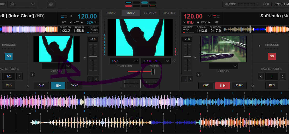

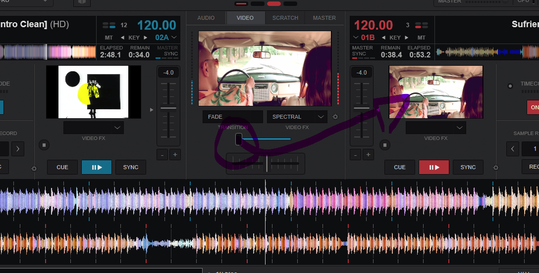

Something fixed with all things that I did.. now the faders on vdj are follow the same direction as the mixer.
But the problem continue witht the video fader.. when I moved to the right show the video on the left and when I move to the left show the video on the right
Manual
Auto
Manual
Auto
Posted Wed 24 Jan 24 @ 4:00 am

The first picture shows the manual video fader to the left but the right video is playing and the audio crossfader in the center. Given you are using an external mixer and probably want that synced yo the video transitions, you shouldn't have the manual video fader on, you should leave videoCrossfader as linked to audio or smart. Are both decks actually playing in the photos? If so are they audibly playing (both upfaders are up)?

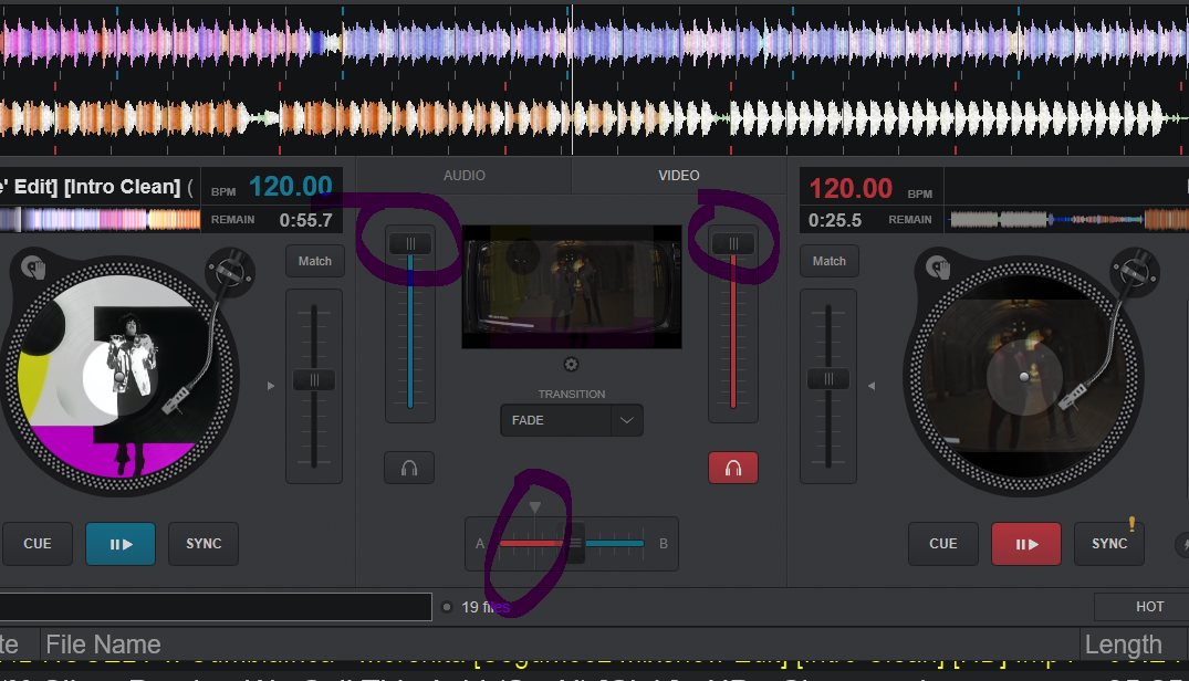

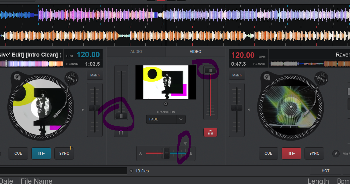

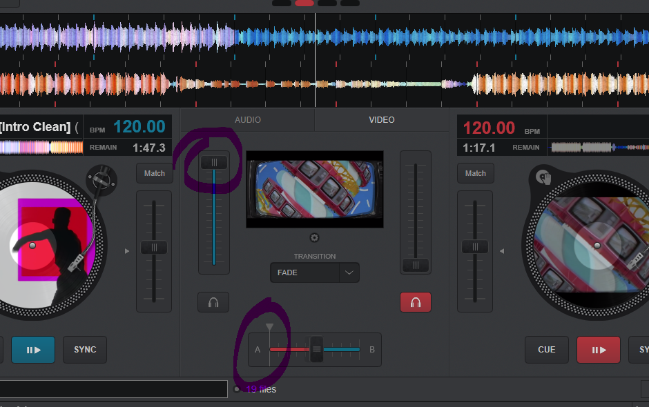

The other pictures do not really show anything wrong in VirtualDJ behaviour - it shows the audio crossfader is still center and the video crossfader is ghosted in a position to give the resulting output video seen. The upfaders in this case only have control over the video fader transition if videoCrossfader is set to linked to audio or smart and both decks are actually playing, since the audio crossfader is at the center position.
