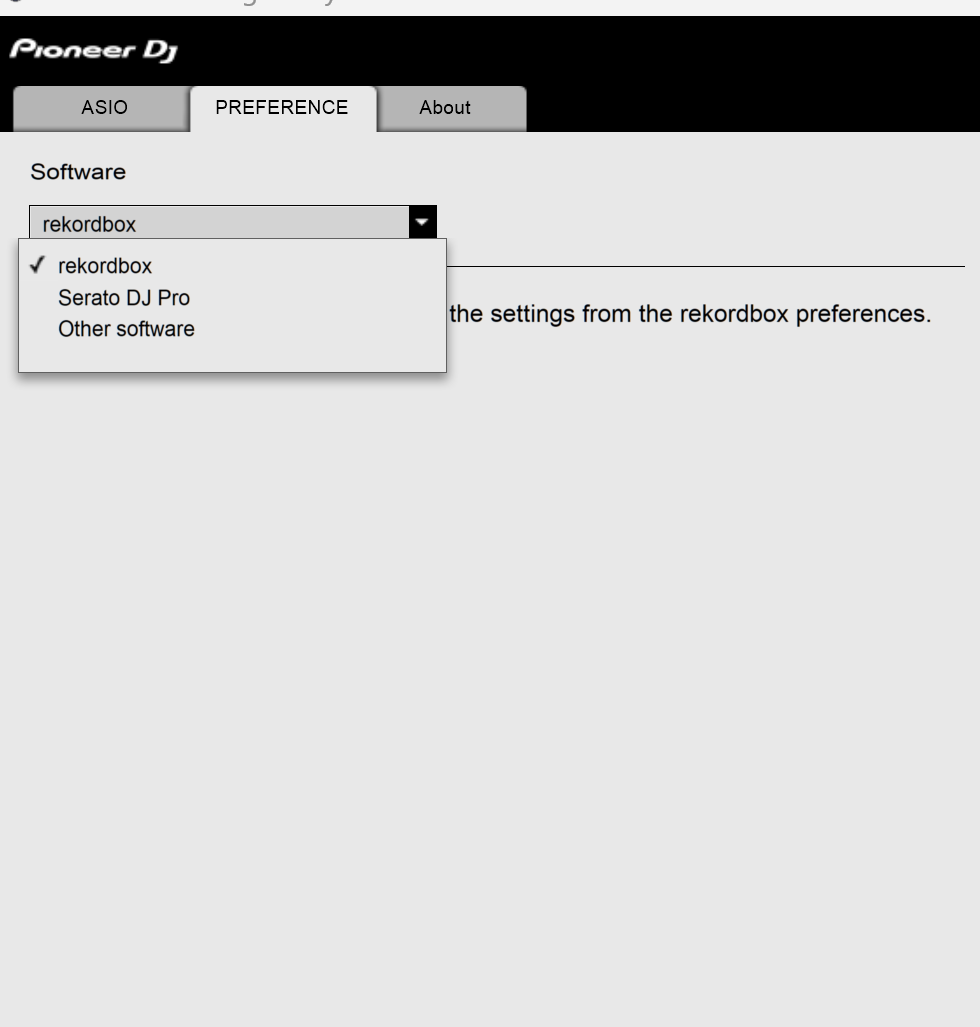

anyways. the driver on the flx 10 has a setting for preference. and it has rb, serato, and "other". does this matter at all? there are some buttons on the flx 10 that seem frozen on vdj like the tempo preset and key lock?

Leave this as it is.
It shouldn't really matter as the software initialization should override it, but just leave it at the default setting.
Finally, recording levels are somehow low with ALL Pioneer units that offer a record loopback channel in their USB bus. That's done by Pioneer on purpose so that your recordings have enough headroom and you won't end up with a distorted/clipping recording.
Some devices offer a setting to change the recording headroom via their "Driver" applet.
FLX-10 doesn't.
FLX-10 doesn't.
