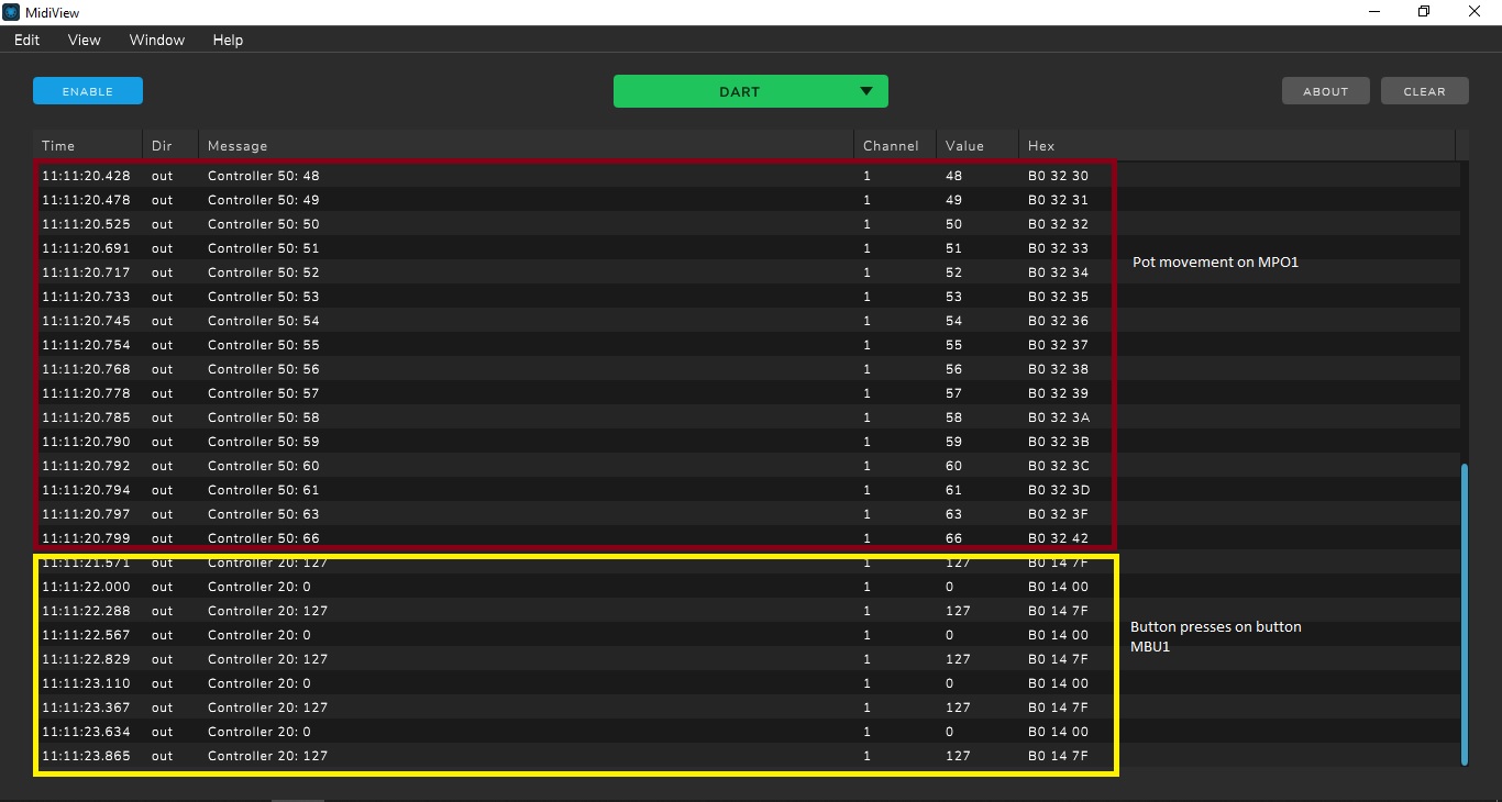

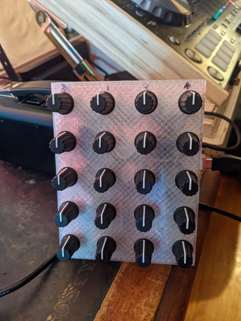

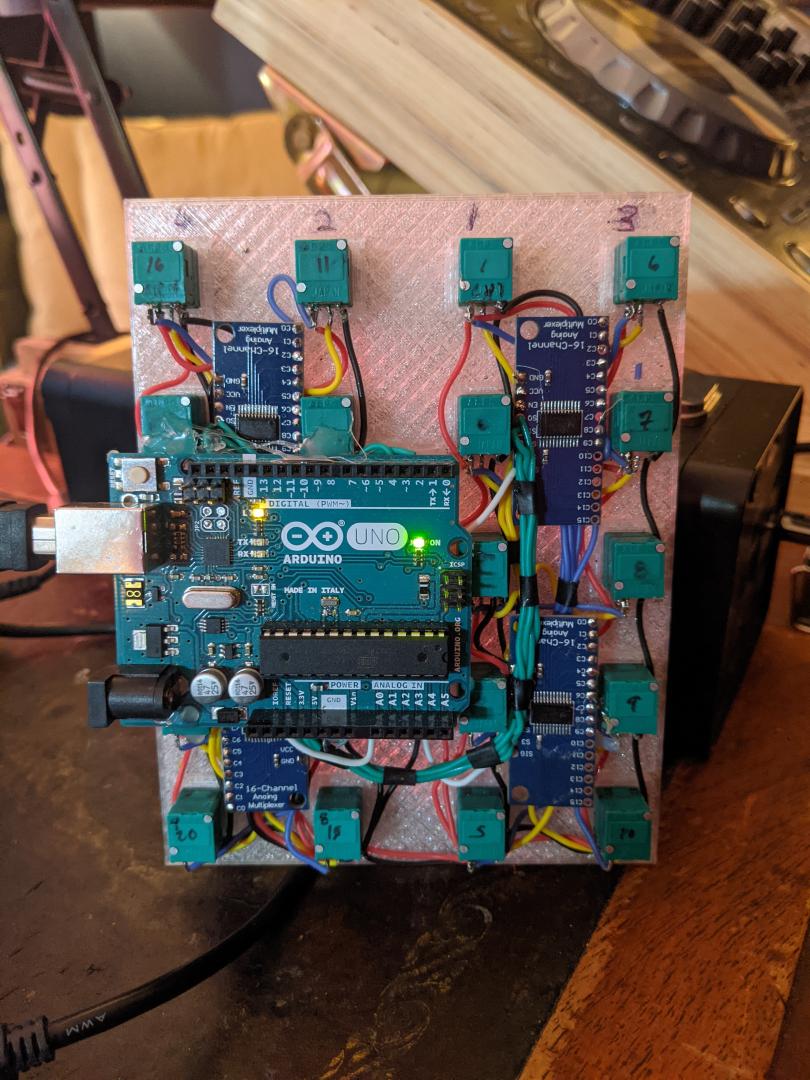

I have been working on a custom midi controller for working with STEMS. It is 20 pots, each with a built in button. It uses 4 multiplexors (2 analog for the pots and 2 digital for the buttons) which feed an Arduino UNO flashed to USB MIDI.
Using MidiView (the link in your documentation for MidiTrace is dead), I am getting correct values for each pot and button when I activate them. But when I try to program the controller in VDJ, it does not recognize any knob or button actions.

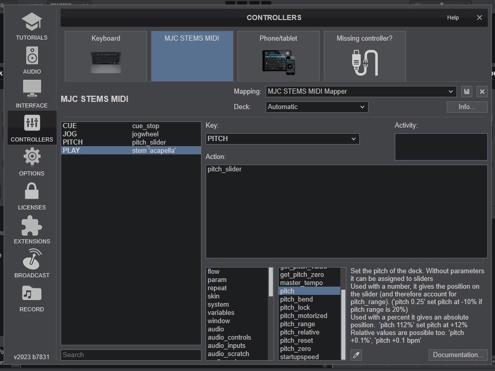

I have created a definition file and mapping file, and VDJ does recognize the controller is plugged in, but again, nothing happens in VDJ when twisting knobs and pushing buttons.
I have tried using different channels and CC messages in my Arduino code. If I use CH0, even MidiView doesn't recognize my input, but it works fine witty MidiView on CH1 and CH2.

Mux M1D_CH1CH3(7, 16, false); //Digital multiplexer on Arduino pin 7
Mux M2A_Ch1CH3(A0,16, true); //Analog multiplexer on Arduino analog pin A0
Mux M3D_CH2CH4(8, 16, false); //Digital multiplexer on Arduino pin 8
Mux M4A_Ch2CH4(A1,16, true); //Analog multiplexer on Arduino analog pin A1

Thanks for the tips guys, I've now got my mapper file showing up in the mapper editor and was able to make a change in VDJ and it showed up in my xml mapper file.
My problem now is that when I activate a button or pot, nothing shows up in the Activity window.
I will look more into VID&PID in the meantime.
Posted Thu 14 Dec 23 @ 2:46 pm

Can you post a screenshot of Midiview (or other), showing what you get when a button is pressed or a knob is moved ?
I have the feeling that the keys in definition dont match with your Arduino code values. One thing i quickly see is that in Arduino code, you have decimal values, while in VDJ definition you put them as hexadecimal .
<slider ccmsb="0x50" name="P0101" deck="1" channel="0"/>
Pot MPO1(M2A_Ch1CH3, 0, 0, 50, 1); //0101 Vocals
So probably you need ..
<slider cc="0x32" name="P0101" deck="1" channel="0"/>
Also it seems that your cc buttons are coded to work as "toggle", so in this case, maybe the <button>s need to be defined as <toggle> too.
I dont see any Note type button in your code?? In definition you have <button note="0x20" name="B0101" deck="1" channel="0" />
Best would be to choose "Command parameter 0=NOTE or 1=CC but not 2=Toggle CC because you will lose the ability to map an action differently when pressed or released.
Posted Thu 14 Dec 23 @ 4:28 pm
Posted Thu 14 Dec 23 @ 4:44 pm
Yes, use the values you see on the far right column.
B0 32 xx is a <slider cc="0x32" channel="0"
and the button is cc="0x14" channel="0"

Thanks again for all the help, guys! I've got it working now!
djdad, thanks for your last post. It was the "fine detail" that I was looking for. I've got all the buttons and pots being recognized by VDJ individually, with all the conflicts resolved now.
Next is to figure out how to write my scripts for controlling the STEMS on each deck, but that is for another thread. For now, I will post the working code below for anyone looking for the same info in the future. If you are reading this, use the code below, not from the previous post. Good luck!
Here's a couple of pics of my prototype. Eventually I'd like to integrate it flush into the computer stand of my rig so that I can tilt it up and lock it in place when I want to use it. 'Till then...

Bcommand = command;
Bvalue = value;
Bchannel = channel;
Btoggle = 0;
void Button::muxUpdate()
byte temp = _muxpin;
temp = temp << 2;
if (_numMuxPins > 8) PORTD = PORTD & B11000011;
else PORTD = PORTD & B11100011;
PORTD = PORTD | temp;
byte Button::getValue()
// If BUSY bit not set - read button
if (bitRead(_status, 0) == false) { // If busy false
if (digitalRead(_pin) == _last) return 2; // If same as last state - exit
// If NEW Bit set - Key just pressed, record time
if (bitRead(_status, 1) == true) { // If new is true
bitSet(_status, 0); // Set busy TRUE
bitClear(_status, 1); // Set New FALSE
_time = millis();
return 255;
// Check if debounce time has passed - If no, exit
if (millis() - _time < _debounce) return 255;
// Debounce time has passed. Read pin to see if still set the same
// If it has changed back - assume false alarm
if (digitalRead(_pin) == _last) {
bitClear(_status, 0); // Set busy false
bitSet(_status, 1); // Set new true
return 255;
// If this point is reached, event is valid. return event type
else {
_last = ((~_last) & 0b00000001); // invert _last
return _last;
void Button::newValue(byte command, byte value, byte channel)
Bvalue = value;
Bcommand = command;
Bchannel = channel;
Pot::Pot(byte pin, byte command, byte control, byte channel)
_pin = pin;
_control = control;
_value = analogRead(_pin);
_value = _value >> 3;
_oldValue = _value << 3;
_value = _value << 3;
Pcommand = command;
Pcontrol = control;
Pchannel = channel;
void Pot::muxUpdate()
temp = temp << 2;
//PORTD = PORTD & B11000011;
Pot::Pot(Mux mux, byte muxpin, byte command, byte control, byte channel)
_pin = mux.outpin;
_numMuxPins = mux.numPins;
_muxpin = muxpin;
_control = control;
muxUpdate();
Pcommand = command;
Pcontrol = control;
Pchannel = channel;
byte Pot::getValue()
int tmp = (_oldValue - _value);
if (tmp >= 8 || tmp <= -8) {
_oldValue = _value >> 3;
_oldValue = _oldValue << 3;
return _value >> 3;
return 255;
void Pot::newValue(byte command, byte value, byte channel) {
Pcommand = command;
Pcontrol = value;
Pchannel = channel;
Arduino: Control.h
#ifndef Controller_h
#define Controller_h
#include <Arduino.h>
class Mux
public:
Mux(byte outpin_, byte numPins_, bool analog_);
byte outpin;
byte numPins;
bool analog;
//Button (Pin Number, Command, Note Number, Channel, Debounce Time)
class Button
public:
Button(byte pin, byte command, byte value, byte channel, byte debounce);
Button(Mux mux, byte muxpin, byte command, byte value, byte channel, byte debounce);
byte getValue();
void muxUpdate();
void newValue(byte command, byte value, byte channel);
byte Bcommand;
byte Bvalue;
byte Bchannel;
byte Btoggle;
private:
byte _previous;
byte _current;
unsigned long _time;
int _debounce;
byte _pin;
byte _muxpin;
byte _numMuxPins;
byte _value;
byte _command;
bool _busy;
byte _status;
byte _last;
byte _enablepin;
class Pot
public:
Pot(byte pin, byte command, byte control, byte channel);
Pot(Mux mux, byte muxpin ,byte command, byte control, byte channel);
void muxUpdate();
byte getValue();
byte Pcommand;
byte Pcontrol;
byte Pchannel;
private:
byte _pin;
byte _muxpin;
byte _numMuxPins;
byte _control;
int _value;
int _oldValue;
bool _changed;
byte _enablepin;
VDJ Definition File
<device name="MJC STEMS MIDI" author="Montalbon Junior" description="MJC STEMS MIDI" version="800" type="MIDI" vid="0x03EB" pid="0x2048" decks="4" padColumns="0" padRows="0" padSides="0">
<!-- Buttons-->*
<button cc="20" name="Vocal_B0101" deck="1" channel="0" />
<button cc="21" name="Instru_B0102" deck="1" channel="0" />
<button cc="22" name="Bass_B0103" deck="1" channel="0" />
<button cc="23" name="HiHat_B0104" deck="1" channel="0" />
<button cc="24" name="Kick_B0105" deck="1" channel="0" />
<button cc="25" name="Vocal_B0301" deck="3" channel="0" />
<button cc="26" name="Instru_B0302" deck="3" channel="0" />
<button cc="27" name="Bass_B0303" deck="3" channel="0" />
<button cc="28" name="HiHat_B0304" deck="3" channel="0" />
<button cc="29" name="Kick_B0305" deck="3" channel="0" />
<button cc="30" name="Vocal_B0201" deck="2" channel="0" />
<button cc="31" name="Instru_B0202" deck="2" channel="0" />
<button cc="32" name="Bass_B0203" deck="2" channel="0" />
<button cc="33" name="HiHat_B0204" deck="2" channel="0" />
<button cc="34" name="Kick_B0205" deck="2" channel="0" />
<button cc="35" name="Vocal_B0401" deck="4" channel="0" />
<button cc="36" name="Instru_B0402" deck="4" channel="0" />
<button cc="37" name="Bass_B0403" deck="4" channel="0" />
<button cc="38" name="HiHat_B0404" deck="4" channel="0" />
<button cc="39" name="Kick_B0405" deck="4" channel="0" />
<!-- Pots-->*
<slider cc="40" name="Vocal_P0101" deck="1" channel="0"/>
<slider cc="41" name="Instru_P0102" deck="1" channel="0"/>
<slider cc="42" name="Bass_P0103" deck="1" channel="0"/>
<slider cc="43" name="HiHat_P0104" deck="1" channel="0"/>
<slider cc="44" name="Kick_P0105" deck="1" channel="0"/>
<slider cc="45" name="Vocal_P0301" deck="3" channel="0"/>
<slider cc="46" name="Instru_P0302" deck="3" channel="0"/>
<slider cc="47" name="Bass_P0303" deck="3" channel="0"/>
<slider cc="48" name="HiHat_B0304" deck="3" channel="0"/>
<slider cc="49" name="Kick_P0305" deck="3" channel="0"/>
<slider cc="50" name="Vocal_P0201" deck="2" channel="0"/>
<slider cc="51" name="Instru_P0202" deck="2" channel="0"/>
<slider cc="52" name="Bass_P0203" deck="2" channel="0"/>
<slider cc="53" name="HiHat_P0204" deck="2" channel="0"/>
<slider cc="54" name="Kick_P0205" deck="2" channel="0"/>
<slider cc="55" name="Vocal_P0401" deck="4" channel="0"/>
<slider cc="56" name="Instru_P0402" deck="4" channel="0"/>
<slider cc="57" name="Bass_P0403" deck="4" channel="0"/>
<slider cc="58" name="HiHat_P0404" deck="4" channel="0"/>
<slider cc="59" name="Kick_P0405" deck="4" channel="0"/>
</device>
Arduino: Mapper File ///
<?xml version="1.0" encoding="UTF-8"?>
<mapper device="MJC STEMS MIDI" author="MJC" version="850" date="2023-12-14">
<!-- Buttons-->*
<map value="Vocal_B0101" action="play_pause" />
<map value="Instru_B0102" action="play_pause" />
<map value="Bass_B0103" action="play_pause" />
<map value="HiHat_B0104" action="play_pause" />
<map value="Kick_B0105" action="play_pause" />
<map value="Vocal_B0301" action="play_pause" />
<map value="Instru_B0302" action="play_pause" />
<map value="Bass_B0303" action="play_pause" />
<map value="HiHat_B0304" action="play_pause" />
<map value="Kick_B0305" action="play_pause" />
<map value="Vocal_B0201" action="play_pause" />
<map value="Instru_B0202" action="play_pause" />
<map value="Bass_B0203" action="play_pause" />
<map value="HiHat_B0204" action="play_pause" />
<map value="Kick_B0205" action="play_pause" />
<map value="Vocal_B0401" action="play_pause" />
<map value="Instru_B0402" action="play_pause" />
<map value="Bass_B0403" action="play_pause" />
<map value="HiHat_B0404" action="play_pause" />
<map value="Kick_B0405" action="play_pause" />
<!-- Pots-->*
<map value="Vocal_P0101" action="master_volume" />
<map value="Instru_P0102" action="master_volume" />
<map value="Bass_P0103" action="master_volume" />
<map value="HiHat_P0104" action="master_volume" />
<map value="Kick_P0105" action="master_volume" />
<map value="Vocal_P0301" action="master_volume" />
<map value="Instru_P0302" action="master_volume" />
<map value="Bass_P0303" action="master_volume" />
<map value="HiHat_P0304" action="master_volume" />
<map value="Kick_P0305" action="master_volume" />
<map value="Vocal_P0201" action="master_volume" />
<map value="Instru_P0202" action="master_volume" />
<map value="Bass_P0203" action="master_volume" />
<map value="HiHat_B0204" action="master_volume" />
<map value="Kick_P0205" action="master_volume" />
<map value="Vocal_P0401" action="master_volume" />
<map value="Instru_P0402" action="master_volume" />
<map value="Bass_P0403" action="master_volume" />
<map value="HiHat_P0404" action="master_volume" />
<map value="Kick_P0405" action="master_volume" />
</mapper>
