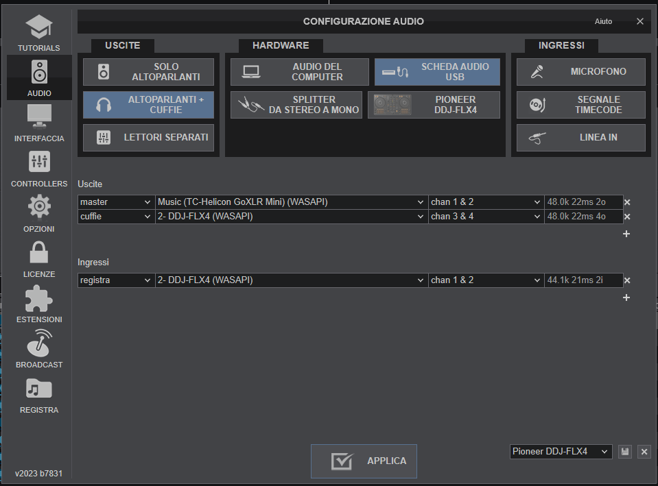

I want audio with this configuration, send the master to music and headphones from the controller output, it doesn't work! I can't hear anything from the headphones.
The same configuration on rekordbox works perfectly, I want to use VirtualDj, I can't solve it, help me!

Click on the DDJ-FLX4 button in your AUDIO setup to create the default audio configuration for FLX4 as seen in manual . https://virtualdj.com/manuals/hardware/pioneer/ddjflx4/setup.html
Then add a 2nd Master output using your other sound card, so have 2 Master outputs there.

solved, thank you so much, you were amazing!
