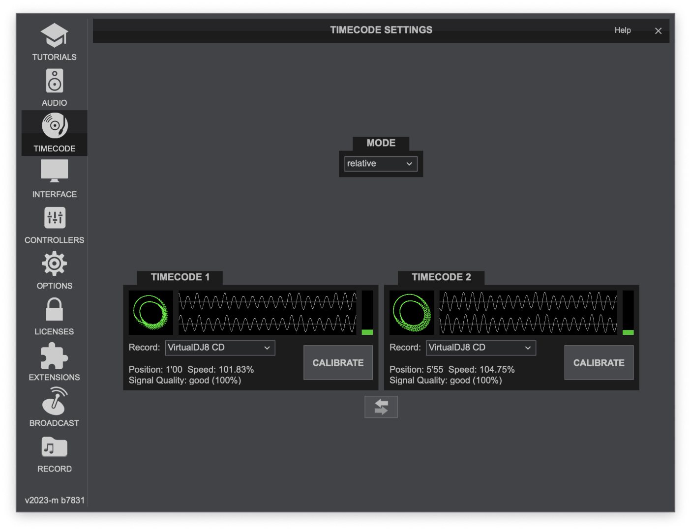

Allow me to rephrase.. it all started with sound slippages (sound jumping of about 1sec I would say), that slipping can also be noticed looking at the wave on the screen.. That where I went to the Timecode tracking menu and noticed the cercles that were not round..

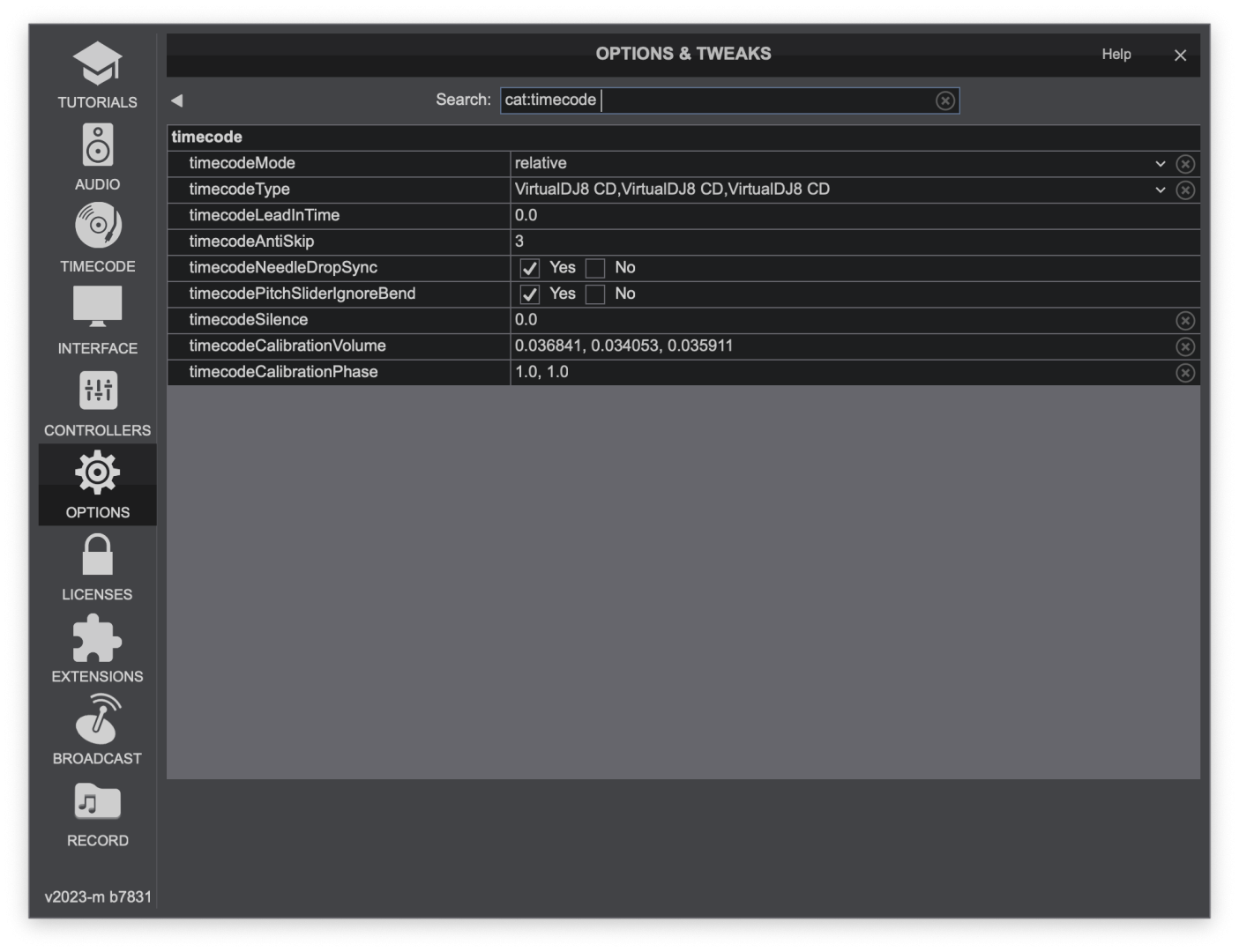

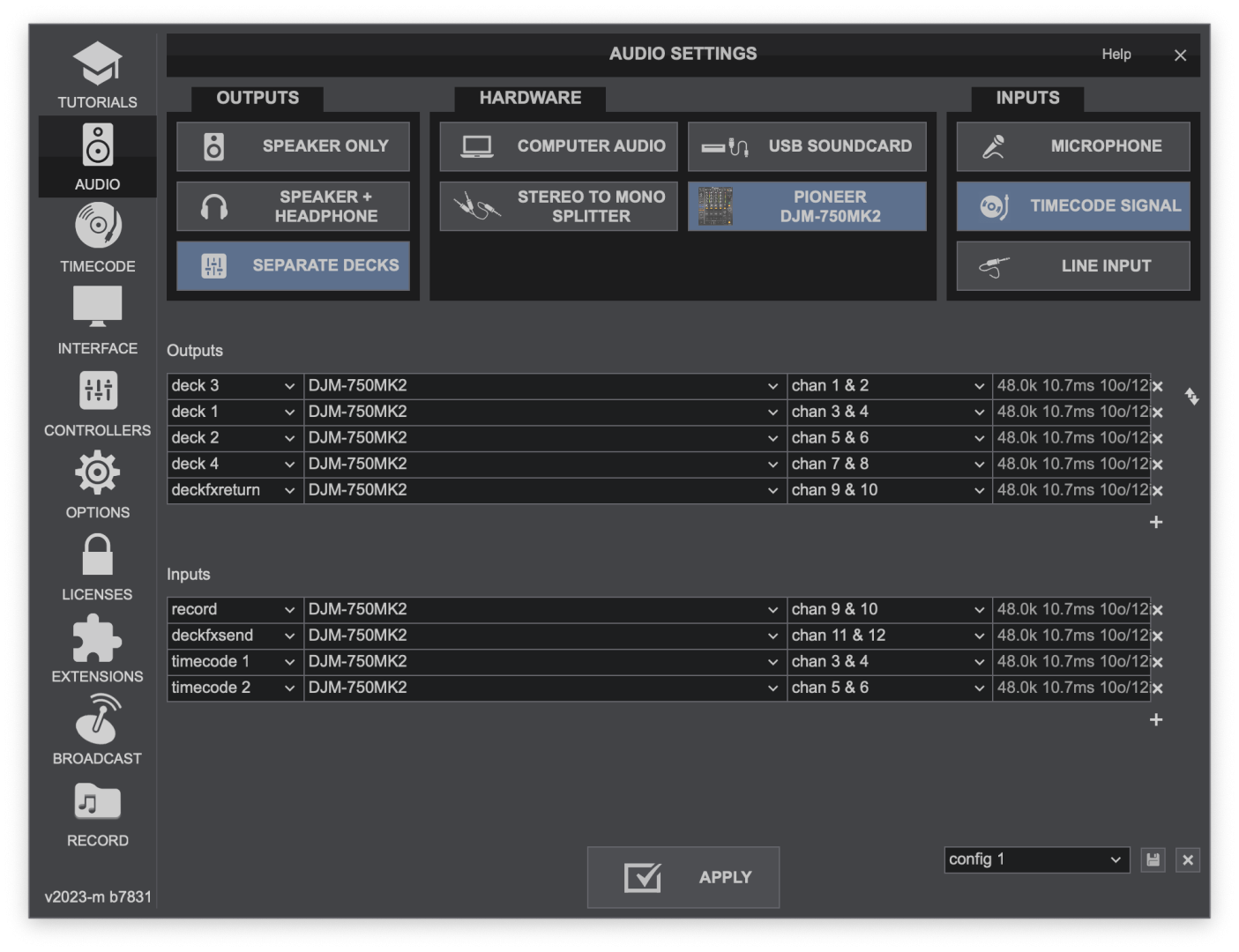

Here attach I'm joining the different screens I found relevant for troubleshooting (timecode, interfaces & timecode options). I also managed to record the behavior. It is very noticable (audio and visual wave).

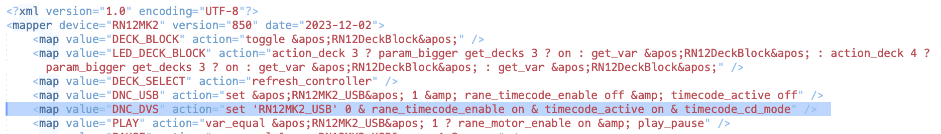

Do me a little favor:
1. Create a custom mapper
2. Close VirtualDJ
3. Open the custom mapper in NOTEPAD
4. Find the key DNC_DVS
Change it like this:
5. Save the file
6. Start VirtualDJ and make sure that you're using the custom mapper for Rane Twelve.
7. Try again.
Do you still have issues ?

Edit 2: Since the forum escapes XML code automatically, here's a picture of the XML code as it should be inside notepad:

Sadly I didn't notice a big change in behavior as making a little test this morning I could reproduce the same sound slippage (cfr new video I'm sharing).
I can confirm I:
- made custom mapper
- closed VDJ
- editted the file based on your indication (cfr screenshot here)
- opened VDJ and selected the new mapper for both Rane Twelve
- closed and reopend VDJ to ensure the mapper applied on the Rane Twelve as I what not sure before)

- Screen you saw is a D8 controller screen, not S8 -> means audio is handled by my DJM 750 MK2 + M1 Macbook Pro
- OK if still reproducable, I could try to bypass the DJM to my mac soundcard

Please try without the NI devices. The NI screens on Mac may have some performance bug.
