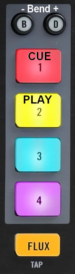

Hi everybody,
User of VirtualDJ Pro for years, I first wanted to congratulate the whole team for the great work accomplished over the last few years to bring our favorite Djing software to a spectacular level, while maintaining ease of use, a very efficient management of the music database , the most extensive device support, and many more... :-)
That said, I would like to have some advices about customizing a NI Kontrol Z2 mixer.
The goal is to add a CUE and a PLAY button for deck left and right. I would like to use the Hotcue 1 and 2 for these like shown in this picture:
Changing constant color for these are pretty easy like:
cue_color 1 : constant '999,0,0' (= red for CUE)
cue_color 2 : constant '0,999,0' (= green for PLAY)
But what about the ability to blink the PLAY button led if deck is stopped or paused ?
For example, I see this code for device Omnitronic CMX-2000:
LED_PLAY_PAUSE: loaded ? cue_stop ? var 'cup' ? on blink : off : play ? on : blink
As default definition file is not editable, is it still possible to define the green color blinking for this original Hotcue 2 button "converted" to a PLAY button?
Thanks to the community,
Iridium

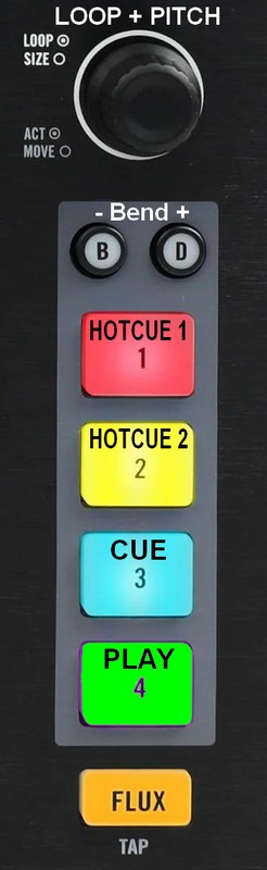

Hi all,
After studying VDJscript a bit, I finally managed to finalize my custom mapper. No so difficult in the end :-)
For those interested in adding transport controls (PLAY, CUE, PITCH, PITCH BEND) to a Kontrol Z2, here is what to modify from the default mapper.
HOT_3: cue_button (playMode to configure in the VDJ options panel)
HOT_4: play_button (cueMode to configure in the VDJ options panel)
HOT_A: timecode_active ? nothing : deck left pitch_bend +2% 500ms
HOT_B: timecode_active ? nothing : deck right pitch_bend -2% 500ms
HOT_C: timecode_active ? nothing : deck left pitch_bend -2% 500ms
HOT_D: timecode_active ? nothing : deck right pitch_bend +2% 500ms
LED_HOT3: pioneer_cue ? color blue : constant '0,0,50'
LED_HOT4: pioneer_play ? color green : constant '0,50,0'
LOOP: var 'syncdown' ? pitch_reset : loop
LOOP_SIZE: shift ? loop_move : var 'syncdown' ? param_bigger 0 ? pitch +0.1% : pitch -0.1% : loop_double
SYNC: set 'syncdown' 1 while_pressed & down ? nothing : sync
Hold the SYNC button down and then use loop rotary to adjust the Pitch (Tempo) of the track.
Hold the SYNC button down and then push loop rotary to reset Pitch to its default (zero) value.
pioneer_play:
It behaves as play_pause. However, when used for leds it blinks when a track it's paused or playing while CUE is held, and stays on when the track plays normally. It turns off when the deck is not loaded
pioneer_cue:
It behaves as cue_play. However when used for leds it blinks when a track is paused (but not on a cue point), it stays on when a track has a cue-point set and turns off when a deck is not loaded.
Hope this helps some :-)
