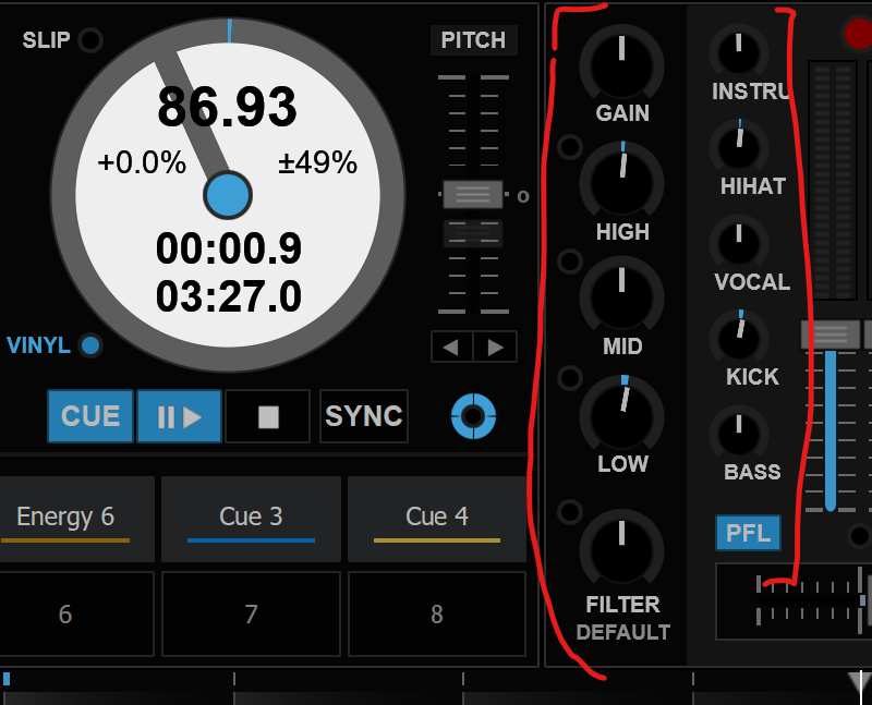

I have a 4 channel controller and where I use 5 knob full mashup control EQ (Frequency EQ on outer channel and Stems EQ on inner channel). However, all skins that I have tried 'overlay' both the EQs (i.e. the same visual knob controls and shows the stem or frequency value. This can cause confusion when mixing.
So I was trying to develop a skin which shows both set of EQ knobs side by side (see image):
