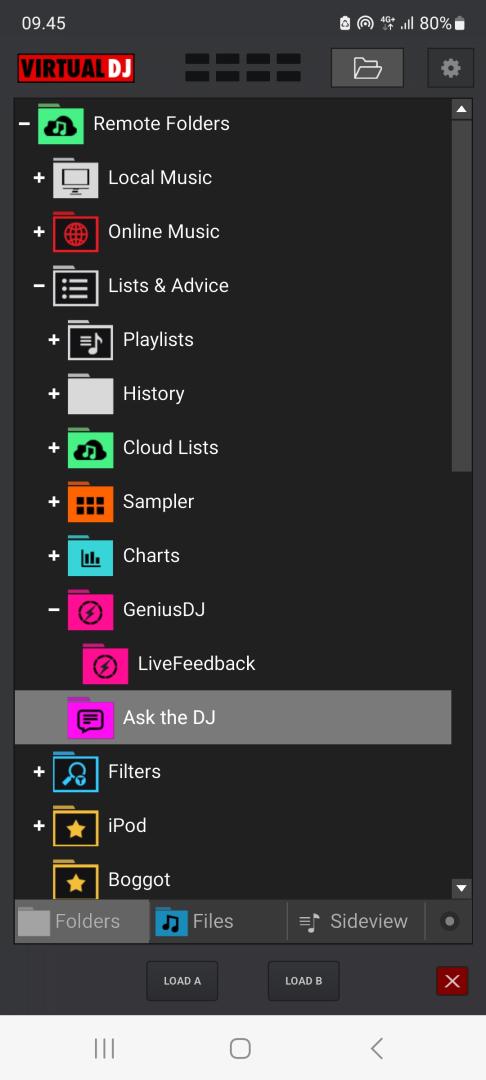

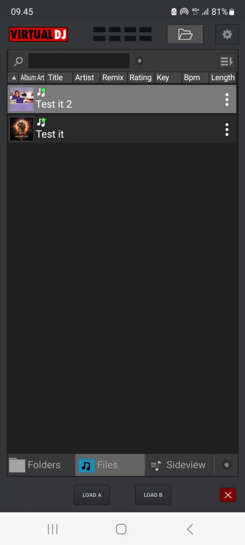

I just tested it, and it does work (at least in the new Android version that was released as beta a couple of days ago)
But the refreshing of the list is a bit delayed - or maybe you have to switch to another folder and back - I didn't have the patience to wait :)
Another thing is that the remote app just sees it as a folder, so it thinks it can always load the request as track, and it will always just load the first match it can find
So if you try to load it and and play it from the app, it will work fine if you have it, (and only have one version of it) - but if the search that is triggered in VDJ doesn't find anything, then nothing will happen. You won't get an empty result
So to actually load and play the request the remote may not be the best option

Well, I’ve just downloaded the app and sent myself three test requests via ‘Ask The DJ’, namely ‘Test 1’, ‘Test 2’ etc. However, on each occasion only the Message part was shown and not the Name bit. Am I doing something wrong and is there a way of the App showing the Sender’s name too?
