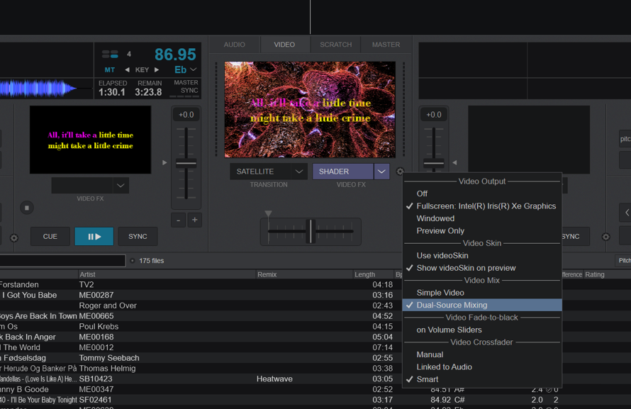

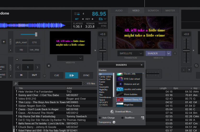

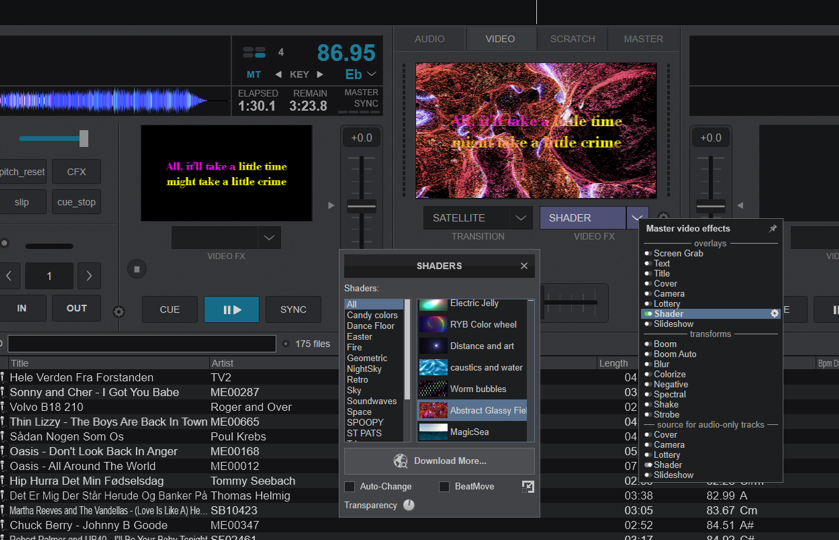

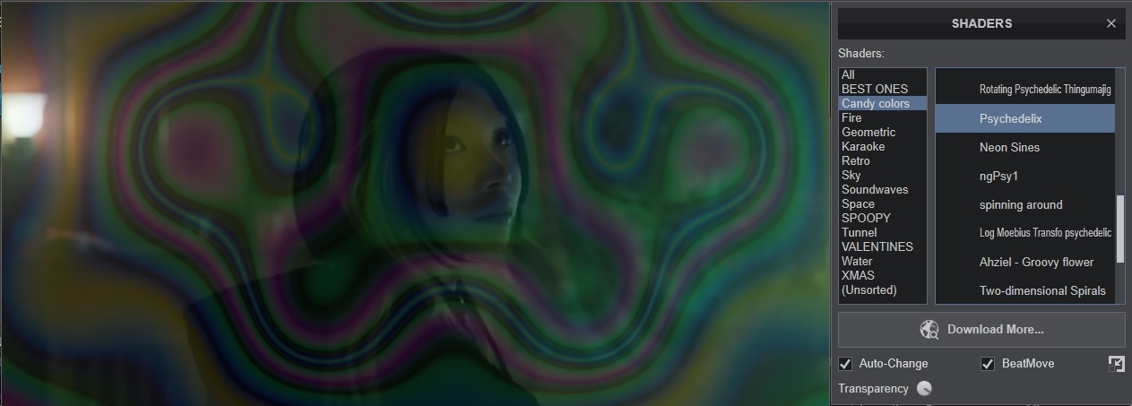

A simple 2 step process is to:
1. Switch to dual source mode
2. Enable shader as an overlay, and maybe pick a shader (or have it auto switch withing a shader group)
You then have shaders on top of a karaoke track/video, AND you can set transparency - like here:
First, thank you for your time. Got it working , somehow. I don't have double options for transitions and video fx. I don't have options for transparency in Shaders options, but I guess it depends on license or video skin. But, never mind, kids will be eternaly gratefull ;-)
