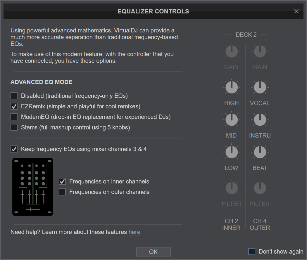

Have you switched SOURCE on the mixer as well (via the screen menu) ?
Edit:
I just tried here like the attached photo and it works fine.
You don't even have to switch decks 3 and 4 to PC control mode (since the knobs send MIDI anyway)

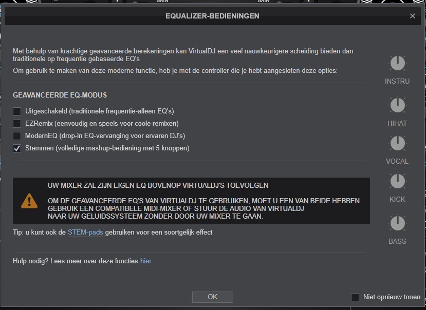

I'm getting this picture on both my laptops and still Deck 1 playing, deck 1 EQ is doing the STEMS instead of deck 3 I'm used to with the XDJ-XZ.
I don;t use the PADS, because I want to change the amount of filtering while playing the song.
Posted Fri 27 Oct 23 @ 4:52 pm
It should be fixed on next update (controllers definition build 2011 or higher)
Posted Fri 27 Oct 23 @ 5:36 pm
