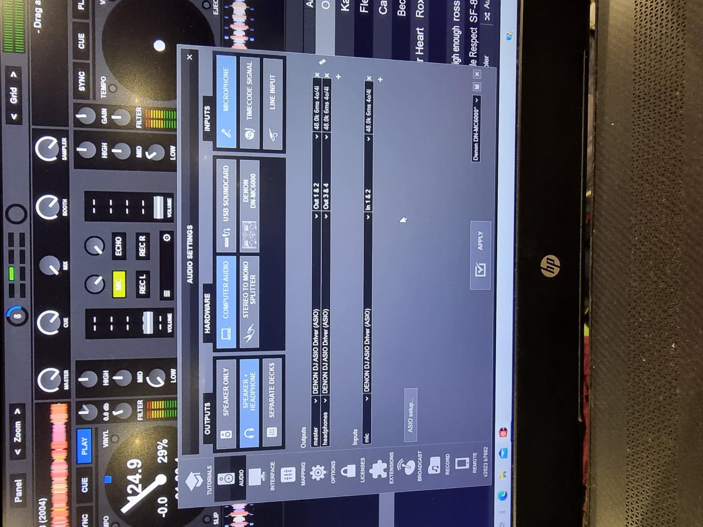

back to basics, please post a screenshot of your audio config

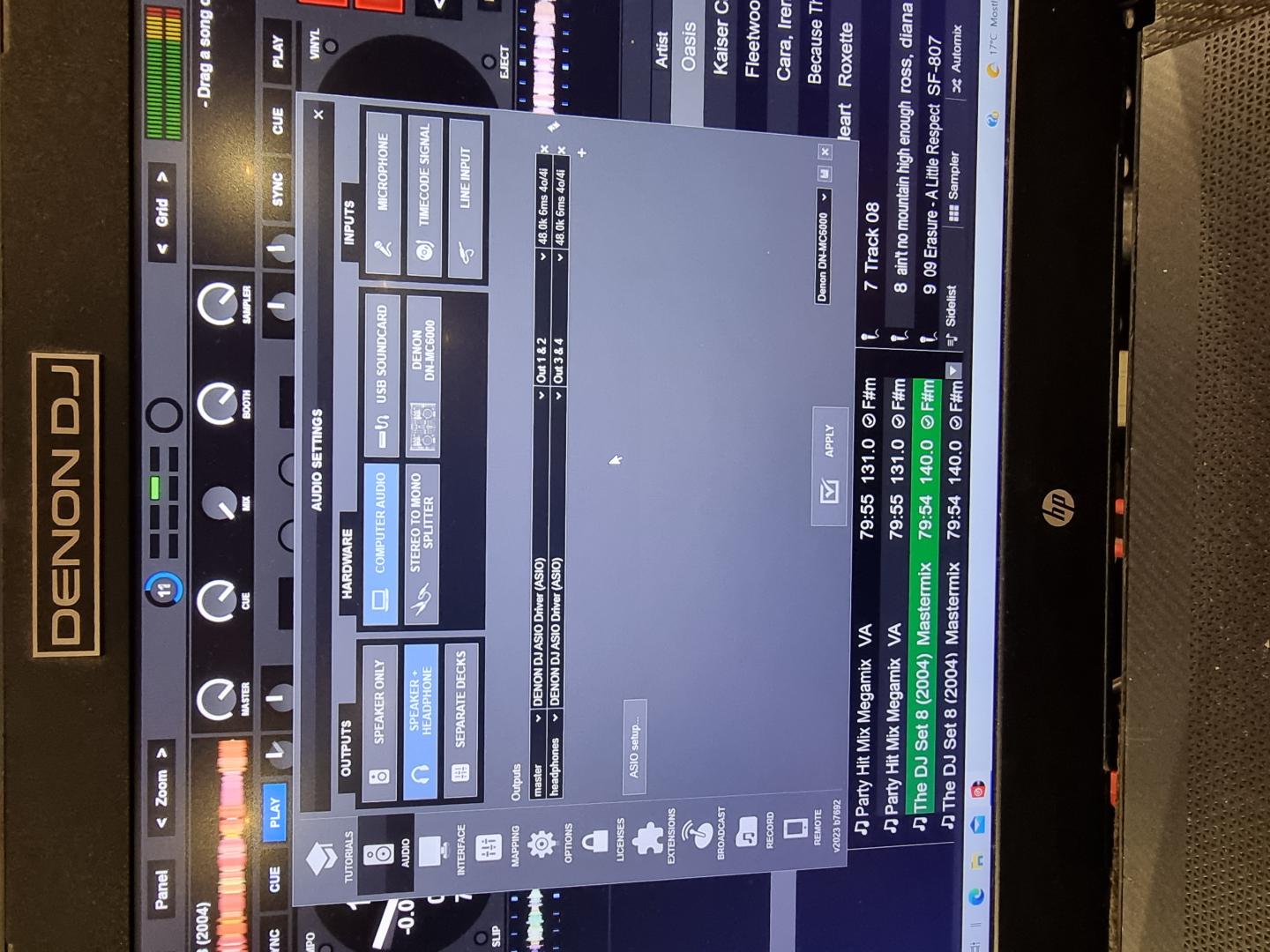

This everything works normally

This is what I try to get microphone to work. Also turn the mic on from the screen and still nothing and the sound sounds very strange
Any help would be amazing please
Posted Sat 07 Oct 23 @ 9:00 am
Since the microphone is controlled by the hardware, you can't use the buttons on-screen, and you shouldn't add a microphone input in the VirtualDJ audio config.
To use the mic, use the buttons on the controller
