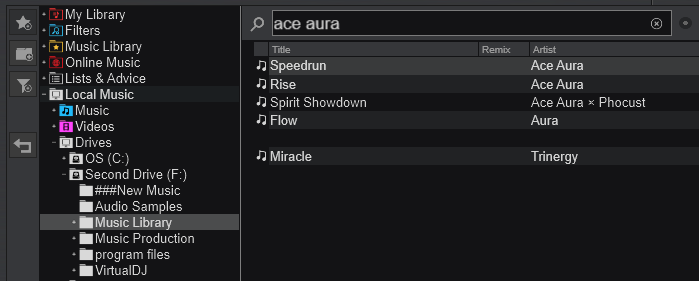

I have noticed several times that VirutalDJ doesn't always see new music I add to the folder that I have set as my music library. Just today I was looking for a higher quality version of a track that I had obtained recently and when I searched for it I was only presented with the older and lower quality copy of the track. Even after I recursed my music library again it still did not appear, yet it picked up several new files by accident that I wasn't ready to have added. (I keep new music in a dedicated folder in my music library directory and will have MusicBrainz Picard tag them and then move them to the correct location typically before I recurse my VDJ library such that they show up with correct [enough] tags.) I even went as far as to check the actual file location after recursing and not only was it was in the right folder, but it was in the exact same folder as the older and lower quality copy! Is this a bug? What can I do to fix this? I'm concerned because several times now this has caused me to wind up with duplicate copies of the same track.

Hey, so I'm back. It turns out the suggestion above did not resolve my issue. There have been at least two instances of this happening that I have encountered still since I changed that setting. Recursing does not pick up the file in spite of it being located within one of the sub-folders of the base directory for my music library. Does anyone have any other thoughts or suggestions?
