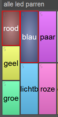

Hi,
In Quick DMX I have scenes that I want to control via virtual DJ. I would like to have the scene buttons activated only when the track is playing and automatically turn off as soon as the track ends.
See my screenshot. I have LED pars. Red blue yellow green. different colors. If I activate red in the track and blue later, it works fine. now blue also remains on. If I want to turn it red again afterwards, I can control it again via a POI via virtual DJ. Red scene was already on from the previous poi. now blue still stays on while I want red. both buttons remain on. I appreciate your help. Maybe I'm thinking too hard or I don't fully understand.
Posted Sat 07 Oct 23 @ 9:33 am
Easier way is to make your Pages to work in "Solo".
Right-click on the "alle led parren" page name and enable the "Solo buttons" from the options list - at least that's how it works in Sweetlight, similar to QuickDMX.
This way you wont worry about turning off the previous color, so each time a POI triggers a color/scene (using os2l_scene 'buttonName' action), the other ones will turn off automatically. And probably useful to add an "Off" button to your page to turn off (Black) your Pars
Posted Sat 07 Oct 23 @ 6:46 pm
Thanks that is a super good idea! It works!
