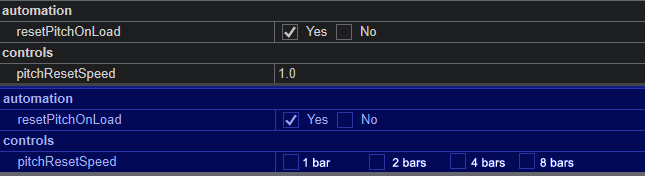

ok, but also no harm to have the pitch reset to work this way no?
here is what i mean, the grey is how it looks now, and blue is my suggestion
