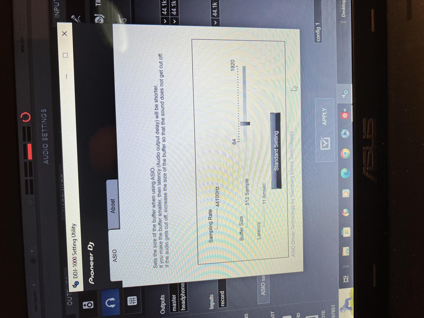

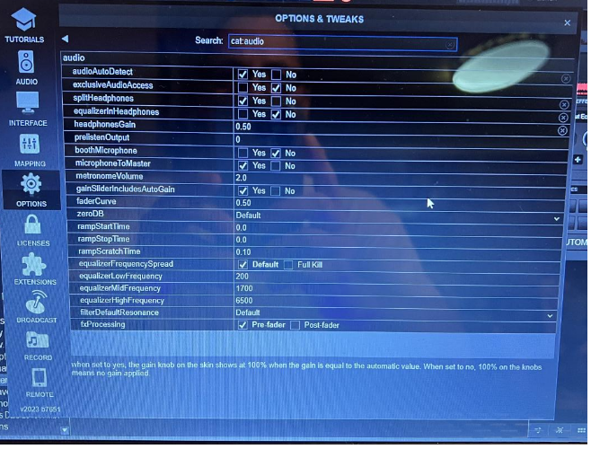

Just started having issues with my headphone volume during gigs. It is very distorted and volume is very low. Anyone know what is going on? Thank you. I have Virtual DJ PRO 2020 Infinity.

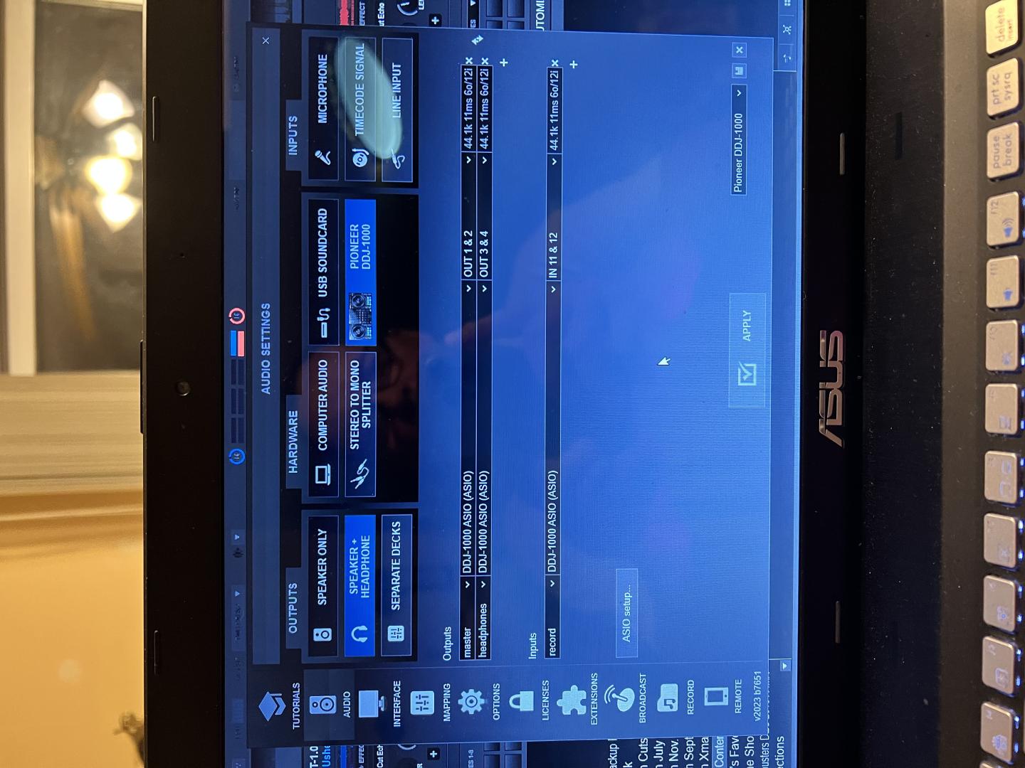

Can you post a screenshot of your VirtualDJ Audio setup ?

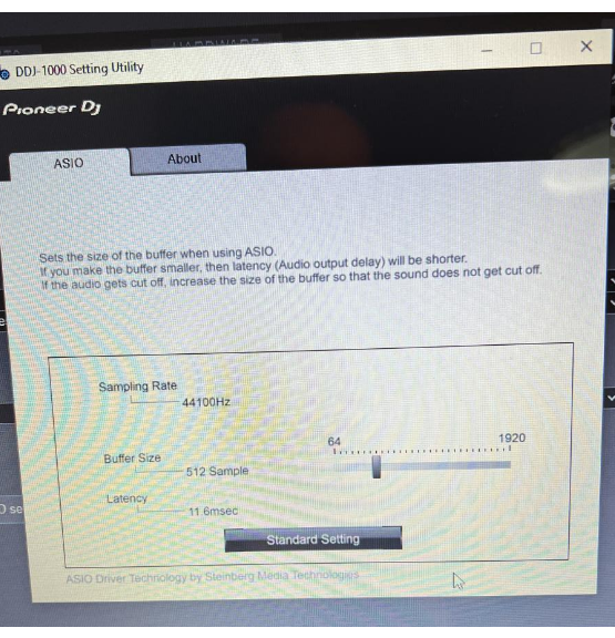

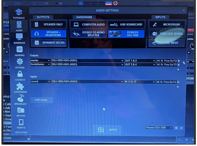

Here are my settings
Posted Tue 26 Sep 23 @ 3:29 pm
Adjusted settings to match yours. Let’s see if that makes a difference. Thank you!
Posted Tue 26 Sep 23 @ 10:20 pm
Nope. Still distorted music in headphones. Ugh
Posted Tue 26 Sep 23 @ 10:33 pm

Problem Solved! Went into my laptop settings. Distortion in headphone is gone!
Settings - System - Power and Sleep - Additional Power Settings - Changed Power 4 Gear High Performance to Balance (Recommended)
