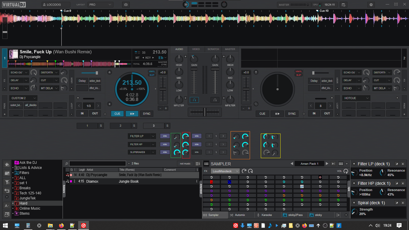

Thing I'm working on, like a merge fx idea thing,
currently the custom_button slider is the thing doing the "controlling"
dials in green box are when the fx will turn on when the controlling dial gets there.
dials in red box are when the fx turns off
the purple buttons to the left of these are USE [actually have the fx turn on & off]
dials in orange are where it watches the controlling dial for fx dial control
dials in yellow are where the fx dials will be translated to as the controlling dial moves
the purple USE button, turns this interpolation function on/off
the < NUMBER > is the dial number that will be acted on
the 1,2,3 buttons are saved preset buttons [s=save, number is recall]
Still bits to figure out

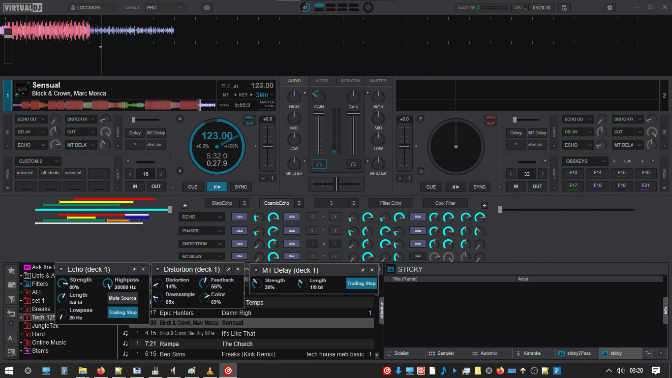

a little more progress, still no prizes for the looks
little red, yellow, green markers to show where things happen on the controlling slider.
Above is on/off points, Below is where it's watching for dial interpolation.
I went with 5 fx profiles 1,2,3 can be fast saved [s button]
4 & 5 are for longer term saving [can only be done with copy paste] you can store as many as you like on the custom_button variations.
If the controlling dial reaches 100% it switches off till it gets back to 0%, I figured that was for the best.
gui buttons, because why not, and the effect select on screen is only deck 1, behind the scenes a rsi copies to deck 2, so that could be a confusion.

Explaining the ugly yet informative visuals,
above our controlling dial is fx on/off
under our controlling dial is fx sliders
