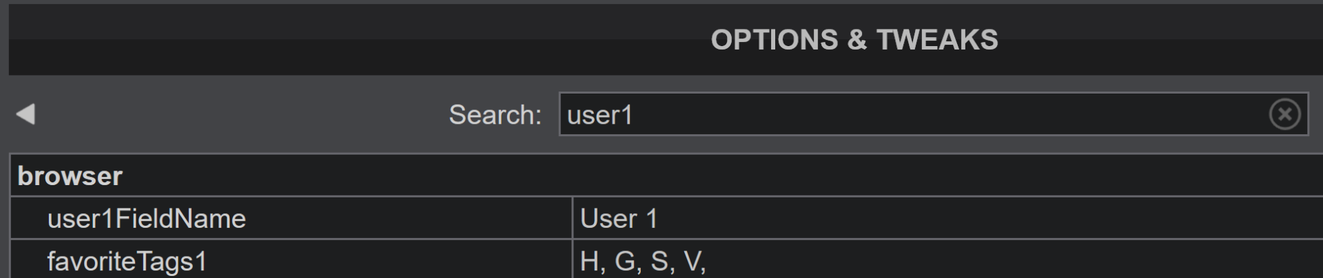

And also, can a MiK Energy level field be added in the tags and sorting in playlist so I do not need to use the comment area?
Yes, one can change the name, "User1" (or User2), by modifying user1FieldName (or user2FieldName) to "Energy" in Options.
And maybe also modify the favoriteTags1 for the values of Energy (you wish to have suggested to you in the Browser Info window's dropdown.)
PS
I wish that the suggested fields would NOT prepend the "#".
(is there a way to eliminate the "#" ?)
Thank you man, that suggestion will do until we get a real field for energy :-)
PS

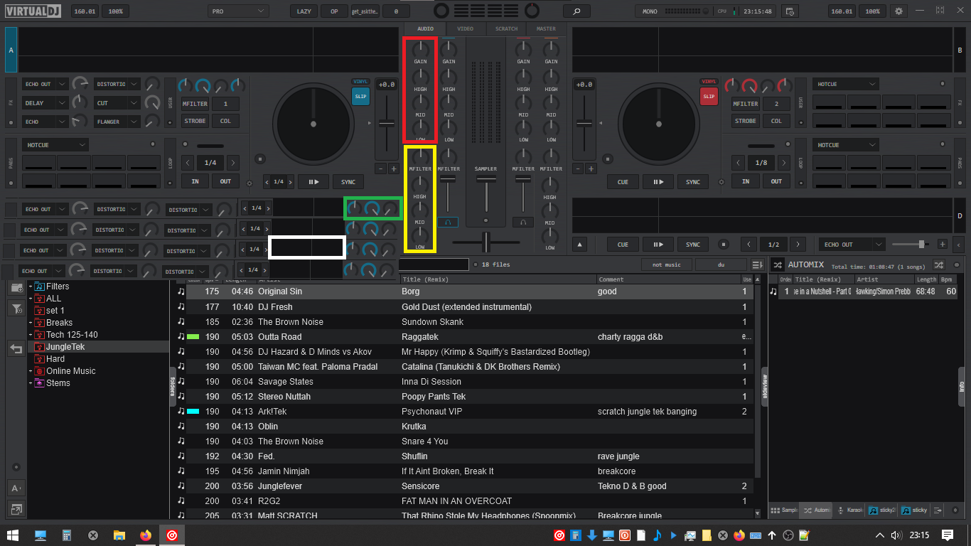

I can't find the skin, I can't remember spending much time on it, I think it was bare minimum after he kept bugging me, he didn't seem to get the mapping was the bigger part of the project.
I just bodged a m$ paint mock up if I was going to make it seriously
red will be level dials
yellow will be color filters
green will be deck eqs
white would be some buttons to snap deck back to follow another deck
looks a bit cramped, I'd cut it to 2 fx slots
probably have something shared between the 4 sub decks for song position.
plus there's a lot in this picture that is just part of my [forever] WIP skin that wouldn't come across, like no rhythm wave, the extra custom dials, custom buttons on the top etc
I honestly don't have much appetite to really make it, but if numbers wanted it with beers as encouragement then maybe.
the real bit is having the HW to control it, you're talking like a launchpad and a bank of dials like FF EC4 or DJTT MFT
Honestly it [the concept] seems a bit much for 1 person live, maybe as a short routine, maybe as a duo trio. Really feels more like a not live venture

Posted Tue 15 Aug 23 @ 11:07 pm
Oh, I was more thinking like using the default skin but having an option to have audio output for 10 stereo stem channels so I can route the audio to any DAW through my Presonus mixer. I think I need one monitor and my dj controller for the beatmatching and one monitor and controls for doing the Dub effects, with for example a DAW that I control with my Akai Midimix and maybe the Push2 or preferably if I get everything to work as a concept, I build a custom Dub Master controller.
I am now using the Amp Freqq as a dub controller software and the midimix with an overlay, but I lack the possibility to add effects EXACTLY where I want them, as you do if you have the the original stems and use a DAW. Thank you anyway for responding, making a special Dubmaster skin would also be awesome, but as I said I do not need to have a million deck and not even the GUI to see all buttons and faders. :-)
