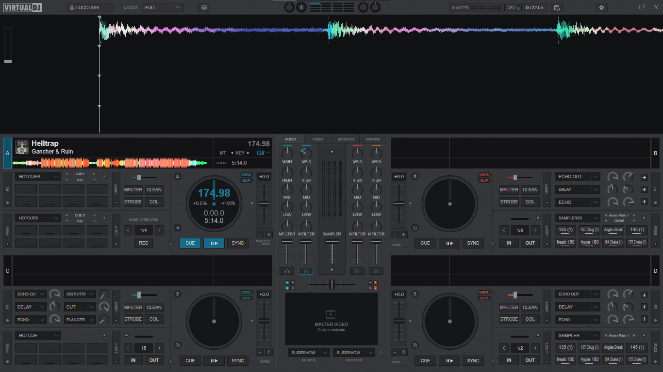

Because somebody requested it, I edited the skin to have 4 full decks pro skin, as you can see, it's a bit cramped [browser is a 2nd window]

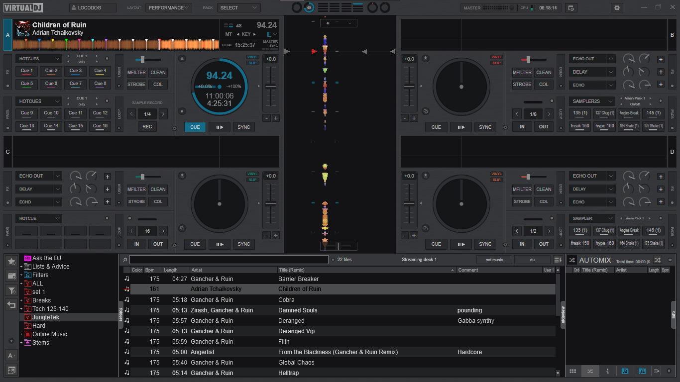

just no space for the browser with 4 full deck and any waves, even with the smaller waves [2 full size or 4 in the same space as 2 full sized] you end up with a 4 line browser.
Do you need waves and browser visible at the same time?, it could be argued not really. That compromise would give you a 10 line browser on a switch, but it's a skinning job.
I'm not too sure if there's any community skins that are 4 deck full but if it exists the proportions will be different.
