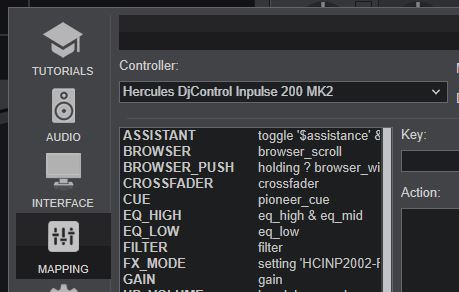

There was really no problem to fix. The controller simply wasn't natively supported in VDJ
But it is on the list now:
![](/img/388454/24262/Capture.jpg)
