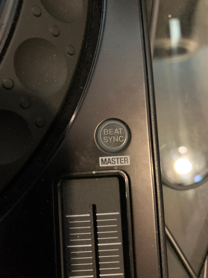

Just moved from rekordbox to VDJ can't understand why I can't activate the beat sync on my controller it jsut flashes for a moment but won't stay on. Have gone back and checked that on Rekordbox it is fine. Is this a VDJ thing??? help appreciated I tried as many things as I could in settings.

The button doesn't do anything except send a midi signal, no matter the software.
in vdj that midi signal is mapped to sync, sync in vdj is bpm match and if playing beatgrid alignment. It's not a mode it's a momentary thing,
maybe you want to use beatlock as is found on the scratch mixer panel.

thanks for reply, In rekordbox when activated the lit up Beat Sync buttons as soon as I hit play the track syncs up. In VDJ do I have to press the Sync on every track?

you want to read about the automation options smartplay & smartcue. And others.
Lots of options and configurations available.
