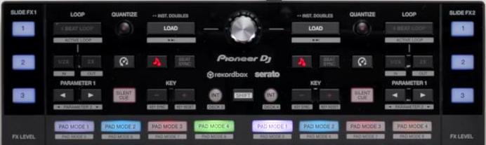

Hi everyone,
Yesterday the Pioneer XP2 arrived and my intention was to totally customize it in the pad pages and in the colors of the LEDs on the pad pages. I managed to do everything and everything works perfectly but when I start Virtual DJ the LEDs of the pad pages go back to the default colors set and I have to press them all (4 normal and 4 with the shift) to get the colors I set. Is it something that depends on the definition file? Is there a way to make Virtual DJ recognize the colors when starting up or is it better to go back to the original colors?
Thank you
Thank you

Which LEDs ? Of the PADs ? Or the PAD_PAGE buttons ?
And how did you "customized" them, if not through VirtualDJ ? (It's not clear to me because you say that they reset when VirtualDJ starts, which implies you had them configured somehow prior running VirtualDJ)

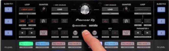

Yes George, sorry if it wasn't very clear, I meant the leds of the pad page buttons. I changed the standard pad pages of the mapping because I already have them in the XP1 and consequently I also changed the default LED colors of the pad page buttons but if I restart Virtual DJ the colors return to the original ones i.e. white, cyan, orange and a shade different yellow than the normal ones and all yellow those obtained with the shift.
Thank you

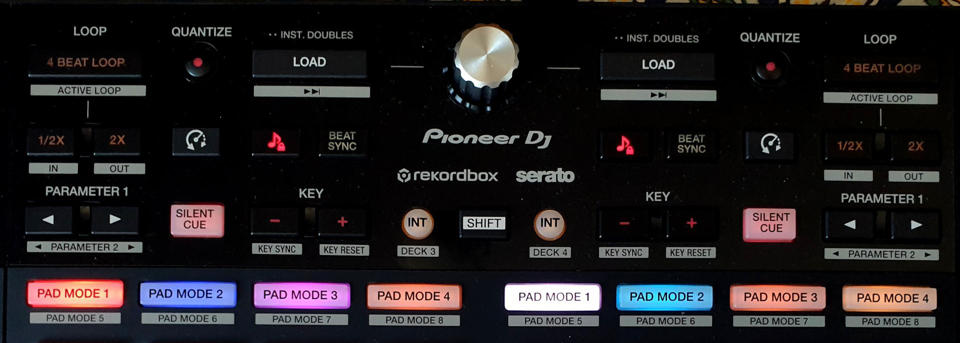

Thanks for the time dedicated to me!
The solution you proposed works only for Pad Mode buttons 1-2-3-4, while 5-6-7-8 remain yellow.
I can also keep the colors of the original mapping but maybe you forgot to assign the "serato" colors to Pad Mode 5-6-7-8, in fact with the default mapping, pressing shift and passing the color to those pad pages of all Pad Mode buttons is yellow while on serato they have different colors.

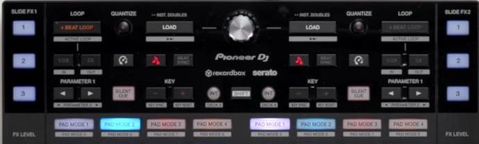

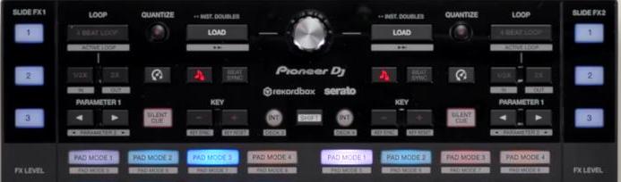

I made some screenshots of the video review.
Right now with the default mapping of Virtual DJ the Pad Mode buttons 5-6-7-8 are all yellow (like in rekordbox mode). As you can see in deck 1 the colors of the Pad Mode 5-6-7-8 buttons on serato are different, they look like 2 shades of green and 2 shades of blue or marine.
Maybe these should be changed in the definition file?
Thank you
Thank you

I'm sorry if I didn't explain myself very well using the translator and I was misunderstood. You always do an excellent job and we all just have to thank you!
In this specific case it seemed strange to me that the Pad Mode buttons 5-6-7-8 all have the same color (yellow) instead of different colors like the Pad Mode buttons 1-2-3-4, I also thought it might be a problem with my unit but luckily it is not.
Since XP2 doesn't have buttons with predefined names like XP1 (Hotcues, Pad fx, Sampler etc etc) but uses Pad Mode 1-8 I thought it could be more comfortable and useful to have 8 different colors to memorize visually than each color corresponds to a specific default or customized pad page. That's why, having customized the pad pages and the colors, I was wondering how to display them all when Virtual DJ opens :)
Posted Wed 24 May 23 @ 8:58 am
