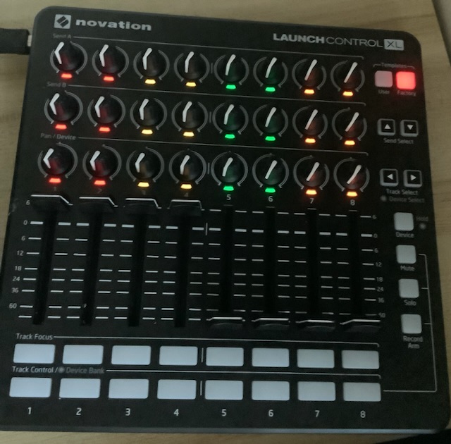

Here’s the controller, mapped modelled on a dubbing desk. I have mapped the channels to kick, melody, vocal and hihat, and the knobs above to echo, delay and reverb on each stem, and the buttons below to muting effects. It is a LOT of fun! Need to figure lighting and get some dub tape echo and spring reverb VSTs installed.

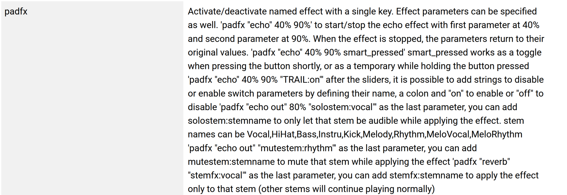

Is this new, and not in docs ?
would indicate that:
"stem names can be Vocal,HiHat,Bass,Instru,Kick,Melody,Rhythm,MeloVocal,MeloRhythm"
Posted Fri 05 May 23 @ 2:11 pm
