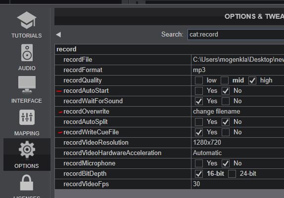

... and on top of the 2 great suggestions above, these 3 settings may also interest you:
1. recordAutoStart - then you always record what you DJ. That's what the DJ schools tells you to do, so that you can always go bank and listen/check your mixes. And then you can of course do a cleanup once in a while, but storage is so cheap and plentiful these days, that you probably only need to do it once a month
2. recordOwewrite set to "change filename" - Then a number is simply added to the end of the file name every time you record, and nothing gets overwritten
3. recordWithCueFile - then you get a small text file next to your recording with a timestamped list of which track you played - and the format of the text files is known in other software and services, like if you want to upload your mix to MixCloud, so that you don't need to spend time manually adding playlists for your mix
