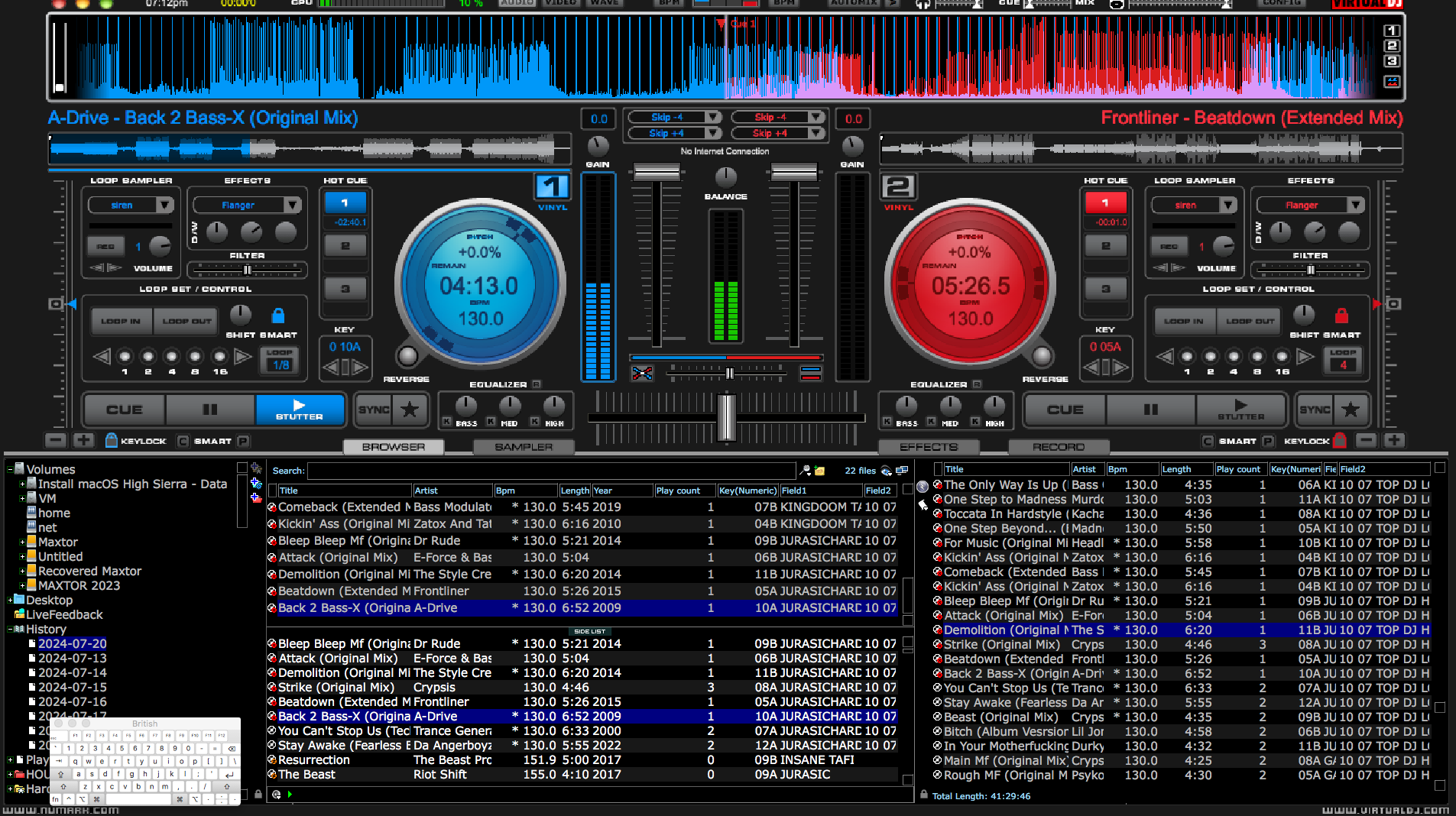

hi this is the skin i use
i coud pay for the job
if is need it
i realy want this comand
i have bean serging
for the last two yeard
i trying to do it my self but i dont indesten codin
i know it is posible for a person who andesten coding
hop you can help
henry vina
Posted Sat 27 Jul 24 @ 3:48 pm
cue rmx by cioce (1366x768)
this is the name
this is the name
Posted Sat 27 Jul 24 @ 3:50 pm
