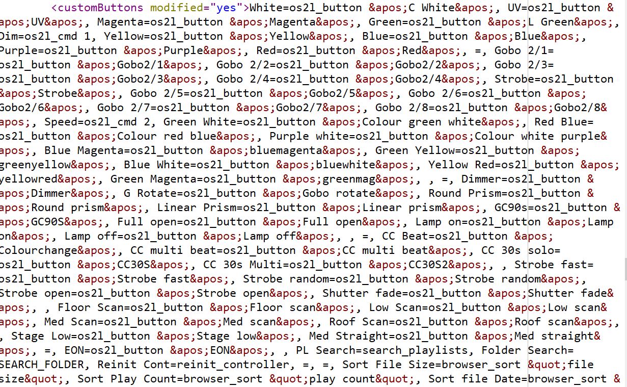

Looking in the settings.xml file they don't appear to be numbered, would be better perhaps if there was some way of editing them in an order?
Example of my settings file below:

Still doesn't explain how they are saved though ..... how does a skin know which custom button to load from the settings.xml as there appears to be no numbering involved?
They are numbered by their ordering... as mentioned.
IIDEEJAYII wrote :
Summary:
everything between the first [...] is the first custom button
and between the 2nd [...] is the second custom button, etc ...
and the between the 3rd [...] is the third custom button called by skin script: custom_button 3
between the 4th [...] is the forth custom button called by the script of the skin: custom_button 4
the 5th is number 5
the 6th is number 6
etc....
So custom buttons all have defined numbers by the order in the list. And each button called by a script in the skin, with a number, defining which button is used.

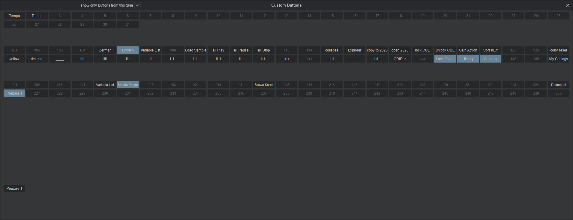

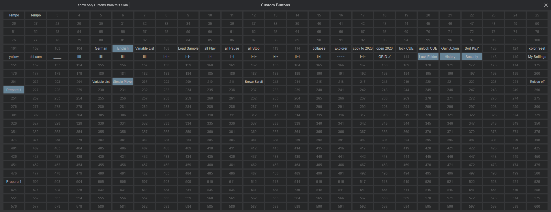

          I have on my new Skin "Project Control" a Window to see Custom-Button 1-600 and on the top line a button that hide all not used buttons from my skin. So you can easy see what buttons you are use for your scripts or actions. but you see all "customs" as button. Any of this are sliders.
