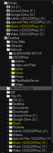

          Thank you for your reply.  I'm very certain that there are little to no actual duplicate files anywhere as I dedicated several hours each day for the past few days removing duplicates.
I actually have been going through and "removing from search DB" already as you suggested and I am finding that things are still being duplicated (and triplicated, if that's even a word) in many cases.
This is the result of having used "remove from search DB" on all "desktop" and drive locations other than the one X drive that I wish it to search in. Additionally I am confused about what constitutes a source that VDJ will put a file in my search database? If you look at the image below, VDJ references the same storage location for my music three times!
Am I supposed to "remove from search DB" on all but one such that my search isn't ruined with having two to three of the same thing populate each time? I wish this wasn't this difficult and obfuscated to figure out...
As far as the "ignoreDrives" suggestion: sounds great, but the only thing I can find for implementing this is reference that it exists and zero information how to use it. There also seems to have been a plugin that used to exist that would calculate what you need to input for this to function as you want it to, but it also seems to no longer exist. This does seem like what I would want, but it seems to be based on some numerical value such as 1=A, 2=B and I've yet to find info on exactly how this works (again, something that shouldn't be this difficult to figure out, but it is).
I mean, maybe my expectations were wrong, but I would hope that this software would be written well enough to not show the same file multiple times in the search and just not do this, but alas.
[EDIT: I realize the third "Music" in my second image is the one on my PC, but still how do I have 3 copies showing everywhere even after specifying to remove two from search?]

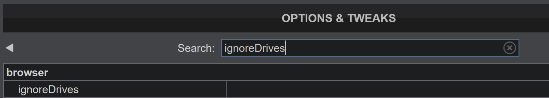

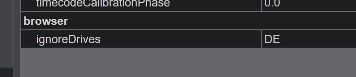

          Ignore Drives is probably the easiest way.
You enter the actual drive letters now.

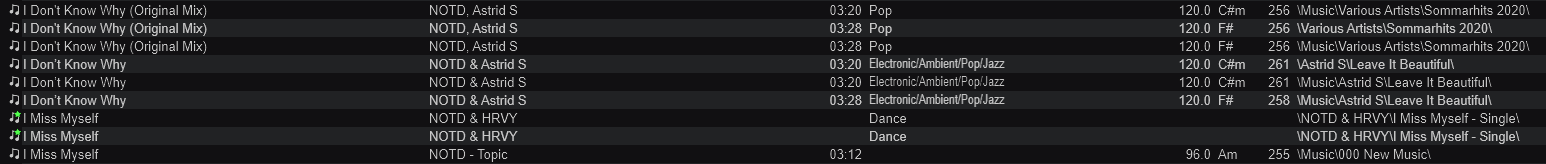

          I want to be forthright and I have found that I still (despite my best efforts and hours spent) have a duplicate file or two still, which is part of the "problem."  However, I see some instances where the duplicate filter is showing a few instances of the same file and path referenced twice, but it is MUCH improved; enough that I think I can call this solved.  Thank you to both of you for assistance as it has helped me IMMENSELY.  I do still hope they update the library/browser to be more intelligent about its searching function because I don't see really anyone probably wanting this as their default experience in VDJ.
