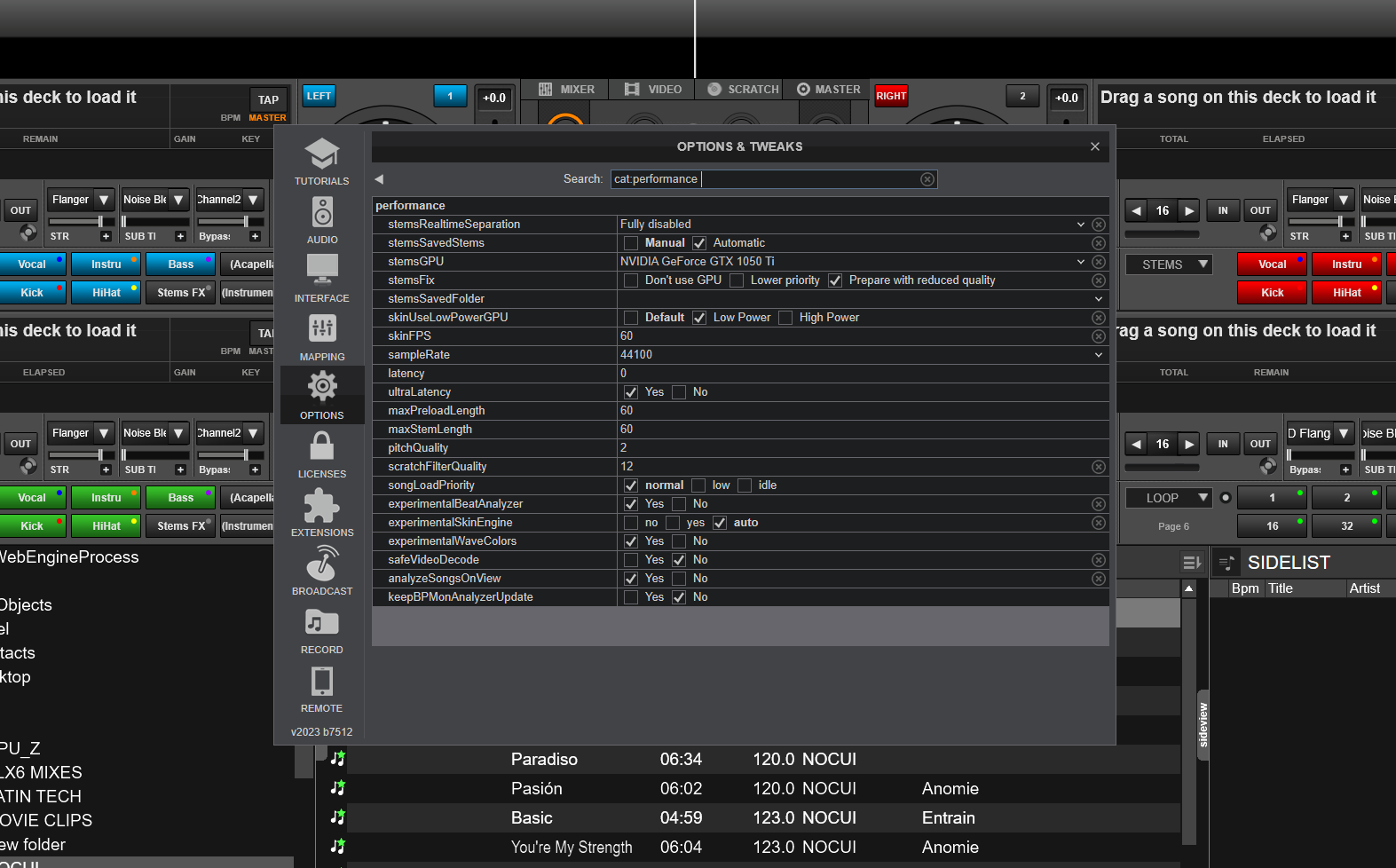

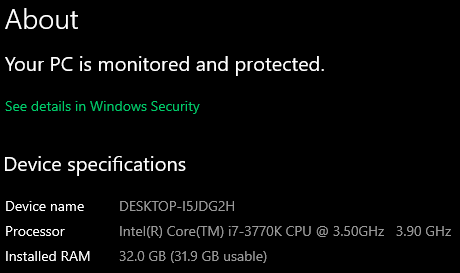

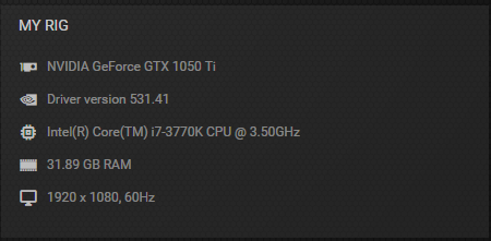

Hi again, sorry I didnt get back to this sooner... but
after much trial and error....
my spec & settings which ''appear'' to be working ''best'' right now
Hopefully this could help someone out there,
I know how frustrating it is when VDJ only says ''stem engine error''
anyway....
happy mixing people :) lets rock
anyway....

From your screenshot you have Stems Fully Disabled ( the first line of your Options > Performance > stemsRealtimeSeparation )
You should easily be able to run stems 1.0 by changing the first line stemsRealtimeSeparation = Reduced quality.
The GeForce GTX 1050 Ti has only 4GB of VRAM, and that seems to be less then needed for the Stems 2.0 stems engine.
https://www.nvidia.com/en-gb/geforce/graphics-cards/geforce-gtx-1050-ti/specifications/
If Djratedxxx919 solution does not improve your ability to use your GPU, for 2.0 stems,
a better configuration maybe:
for realtime stems 1.0, unless you do NOT want to ever use stems.
(if you Never want to use stems, set stemsRealtimeSeparation = Fully Disabled)
and
stemsFix = Don't use GPU
so you can pre-prepare 2.0 stems with the CPU, for those tracks you wish to have the best stems available and stored on disc. (NOTE: will require about 4.5x storage on the drive, for 2.0 stems per track)
stemsSavedStems = Manual
so you can choose which tracks to have 2.0 stems saved.
Done by the R-click menu for a track, or moving a track to the "Stems" Folder located at the bottom of your Folders list.
(then moved to the Prepared subfolder, once the CPU has created/prepared the 2.0 stems when not performing. NOTE 2.0 stems will always be used if they are available/prepared, even when you have stemsRealtimeSeparation set to reduced quality (stems 1.0))
UPDATE/CORRECTION:
The GTX 1050 with 4 GB of VRAM, does in fact meet the requirements for stems 2.0 according to Atomix.
So the GTX 1050 Ti should be above the minimum.
It's the RTX that requires 6GB of VRAM as minimum.
https://www.virtualdj.com/wiki/Minimum%20system%20requirements.html
Report with your success with 2.0 stems.
Posted Thu 06 Apr 23 @ 6:31 am
