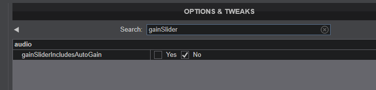

Test with the folow option:
Posted Thu 16 Mar 23 @ 10:39 am
i don't know what you mean... Nice, but if the Level of the Gain is +3db with this script it goes back to 0db instead to +3db. Is there a way to go back to the latest position?
The script save the start value of the GAIN knob and set after fading the GAIN knob to the the start position.
When the Gain knob is 48% the script ends with 48%
When the Gain knob is 55% the script ends with 55%
