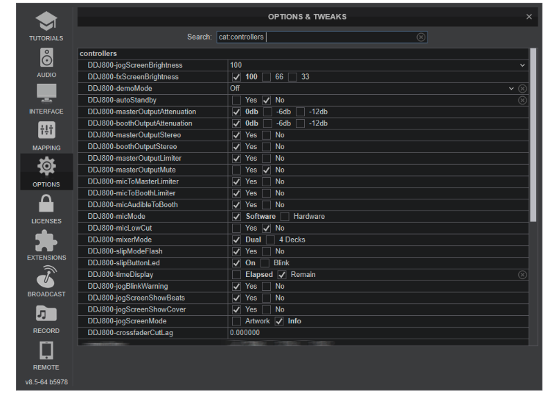

just got the ddj 800 and i use a new bac book pro . but i cant get the mic to work on the unit , it works perfect on record box , but not vdj . when you start up the mic works but soon as you open vdj and it finds the 800 it cuts the mic out , can eny one help

iv found the issue , in OPTIONS-CAT,CONTROLLERS ,the mic is set to software , this needs to be set to hardware if any one else has this problem

thanks this was my problem
