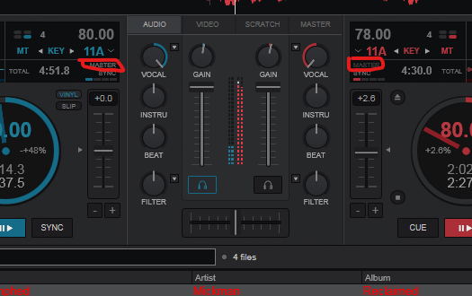

![](/img/376430/65524/Screenshot 2023-02-27 082704.png)
So when playing two tracks, i am clicking on the MASTERDECK buttons shown above. generally if the crossfader is centered, there is no issue switching which deck is currently set as master.
The issue is occasionally the MASTERDECK button will stop working entirely for a single deck until the program is restarted - the GUI will just show it as unselected, and clicking the button will not enable master no matter what, even if that is the only track playing. (note - clicking master WILL enable cueing for the selected track, but doesn't select the track as master).
In addition to ruining bpm syncing, this breaks all my filters as they require master information to update.
any advice would be appreciated (although technically I think this is just a bug with no help possible)

I had this similar issue before, and this is something I had found out that may be helpful (or not) here:
To reset the logic to 2), you have to right click on the Master option for that same deck.
Summary/Takeaway:
Try right-clicking the Master button of the affected deck and then going through a sequence of track loads to see if it resolves your issue.
- There is a difference between the master deck and active deck
- Active Deck normally seems to follow the active sound (which normally follows the crossfader direction) - it only seems to switch when the active sound is completely to one deck and it is audible.
- Master Deck really control what the sync of other decks and other things (like filter buttons based on range) use as their guide
- (Normally) Master deck automatically follows the Active Deck
- (Most Importantly) If you manually click on the Master option for a deck, it overrides the automatic following logic and leaves that deck as the Master deck
Summary/Takeaway:
