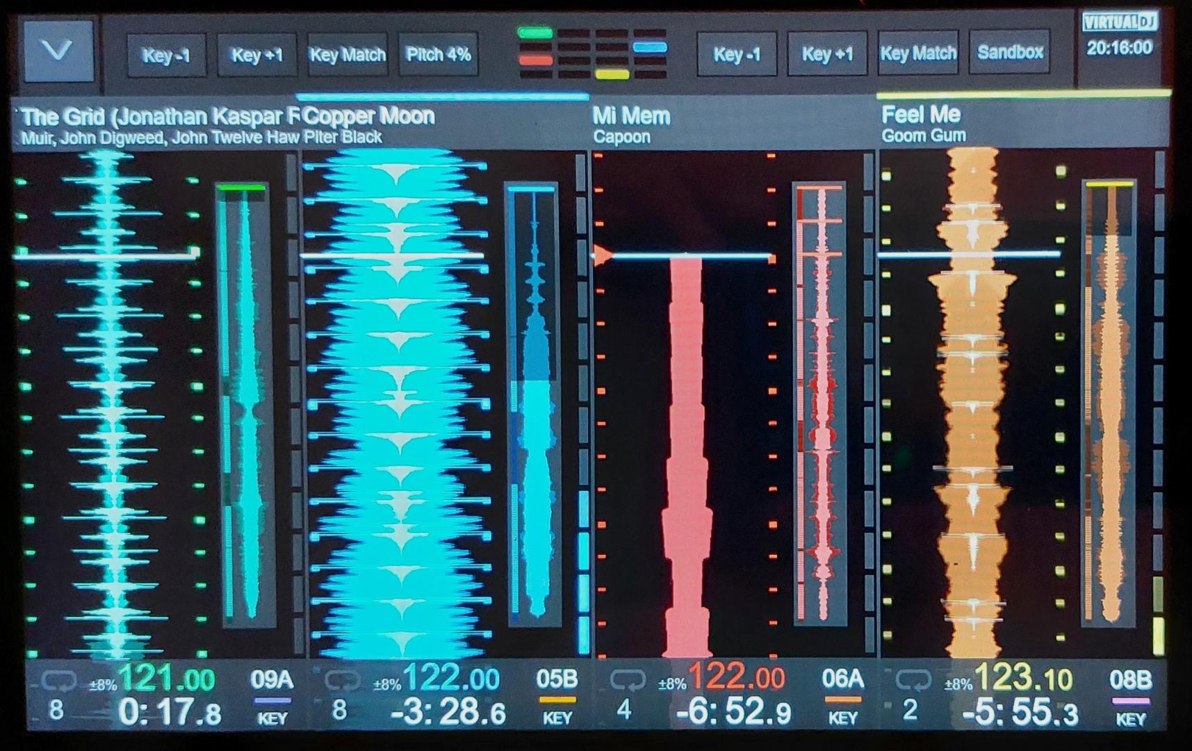

Hi all,
I'm trying to build a 4-Decks vertical skin for the Denon Prime 4.
Here is a work-in-progress screenshot:
I wanted to integrate the songpos next to each scratch wave. Then I found, that this is not working. I found some old topics on the forum , stating that this is not working in v7 so far.
Will this be supported sometimes? Maybe I'm not doing it correctly. Can anybody post a snippet on a vertical songpos element?
Thx and cheers
Jochen

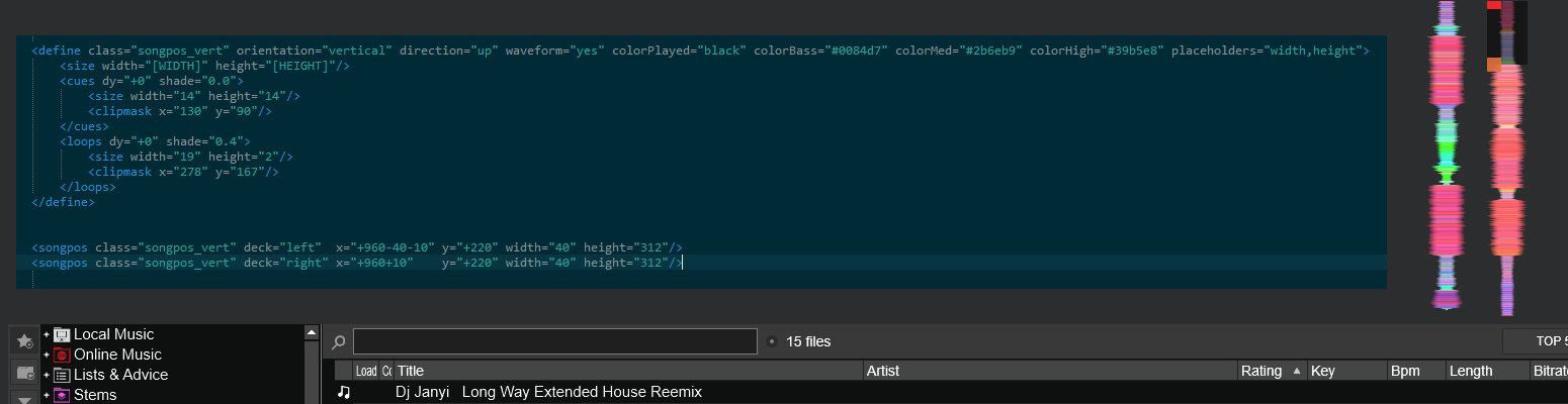

According to my tests, the vertical songpos seems to work only when you set a define first...
Posted Sat 11 Feb 23 @ 5:12 pm
Hey ALEXRDZAIK,
you're right and thank you so much for the workaround.
Like this I was able to proceed with my vertical skin for Denon Prime 4:
Thx and cheers
Jochen
Thx and cheers
Jochen
Posted Sat 11 Feb 23 @ 7:25 pm
Excellent, your skin looks great. 😯
Posted Sat 11 Feb 23 @ 7:42 pm
Thanks man,
will continue to improve it and make variations for Prime 4, Prime Go, and SC Live 4. Maybe I'll provide it for download afterwards.
Posted Sun 12 Feb 23 @ 8:32 am

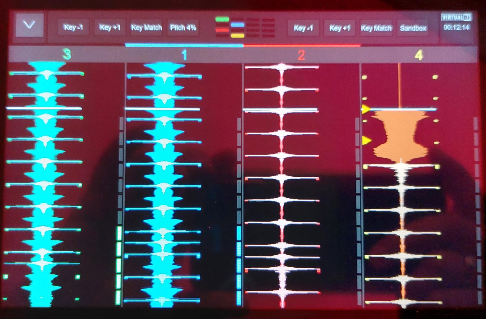

Hi Jochen. Would be Great to have it inplemented in my skin. You can do so, if you want. If you need any help, let me know. I have same skin to prime 2 and Prime go too.
Regards Tomas.
Regards Tomas.
