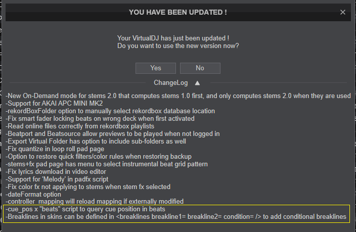

Big thanks to Atomix ...

Indeed super quick to be added too.

@tsi, it's a skinners thing, as you know most skins , if you resize them the decks stay the same aspect ratio, but the browser deals with "elastic" spacing, that's because of a breakline, a breakline tells the skin "anything under this pixel line can be resized and I don't care about the aspect ratio" before it was always the browser that aspect ratio didn't matter.
breaklines were fixed, you could say breakline between this line & this line, but if your skin layout moved browser around, it looked a mess. I'll post some pics
