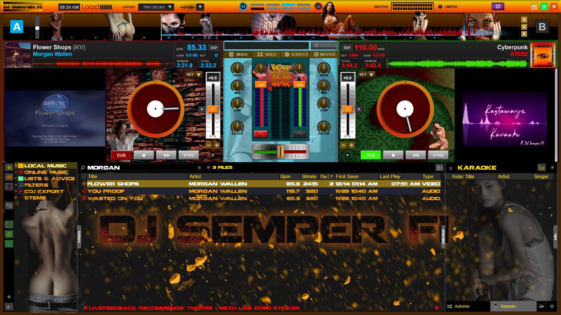

I've been working for a few weeks on a pretty detailed skin edit. What's giving me trouble is I like putting graphic images in my vumeter but it keep repeating the left side of the graphic.
The default code from the modern skin appears to use the get left and get right in reference to the vumeter class and shows the appropriate movement over the 12 pixels. So I can't understand for the life of me why both left and right channels on the decks are doubling up the left half of the graphic.

here's the first source for the main vumeter when the class is being defined:
<define class="vumeter" classdeck="left" type="linear" orientation="vertical" direction="up">
<size width="11" height="251"/>
<off x="1032" y="1143"/>
<on x="1168" y="1143"/>
</define>
<define class="vumeter" classdeck="right" type="linear" orientation="vertical" direction="up">
<on x="1204" y="1143"/>
</define>
AND THEN THE PANEL CODE ITSELF
<panel name="vu_meter" group="vu_levels" visible="no">
<visual class="vumeter" deck="left" source="get_vu_meter_left">
<pos x="+0" y="+0"/>
</visual>
<visual class="vumeter" deck="left" source="get_vu_meter_right">
<pos x="+12" y="+0"/>
</visual>
<visual class="vumeter" deck="right" source="get_vu_meter_left">
<pos x="+34" y="+0"/>
</visual>
<visual class="vumeter" deck="right" source="get_vu_meter_right">
<pos x="+34+12" y="+0"/>
</visual>
</panel>
If I'm understanding this it SHOULD be looking the 12 pixels to the right of the left channel source image for the right channe source. but the +12 doesn't seem to be impacting it. My old VirtualDJ 7 skins have always done this no problem but this seems to be an issue this time around.

i'm not sure what to fix then. do i remove the class and make it per deck under the audio mixer panel?
Posted Tue 31 Jan 23 @ 8:10 am
oh, and they define the class in the first part. it's not a default class, but if it's defined at the top of the script, it's like calling on a section of script above already written. though idk why you'd do this for a singular instance.
Posted Tue 31 Jan 23 @ 8:12 am
i figured it out. I created a second set of the class with the +12 for the X's and repositioned the location on the .png and it works perfectly. for whatever reason, the default code uses a single source on the .png and adjusts for both channels. seems like a weird strategy when your .png has a left and right channel visible. why have two if you only use one?
