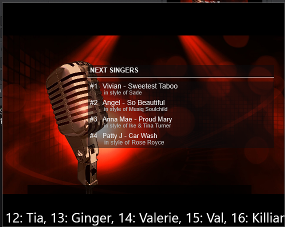

BINGO!!! I still had difficulty figuring it out, but after a lot of trial and error, I got exactly what I wanted which is this. A short singer list on top of a background image with the complete singer list scrolling on the bottom.

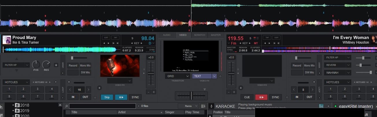

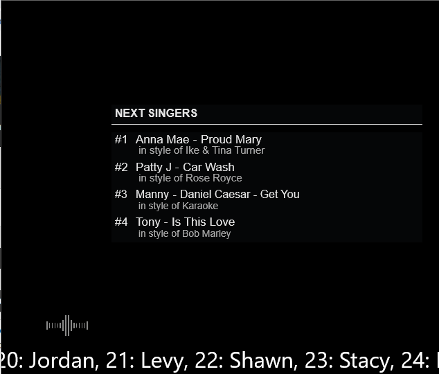

This is so weird. I know I posted earlier that I accomplished what I wanted, but that was several hours ago. Just checked again and it's not working no matter what I do. I have the singer list but now it has a black background. (See 1st image)
The background image I want in there is on deck 1, but I can't get it under the list. (See 2nd image)

the Video Crossfader is at the right side (the gray triangle over the Audio Crossfader). Either move it on the left side or press the Skip button for a while on the Left (Background Music) deck
THANK YOU!!! You pointed me in the right direction and now I got it how I want it. I had to change the video crossfader setting from SMART to MANUAL. Then move the video crossfader to the left.

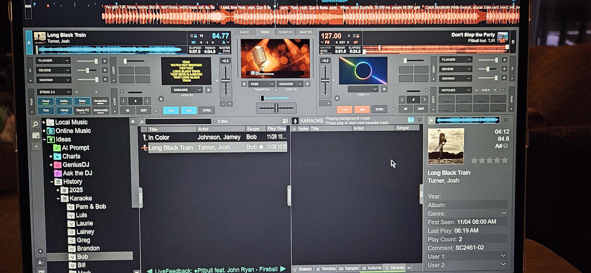

Hi so I'm fairly new to Virtual DJ but I've been doing a few karaoke gigs successfully. I'm trying to figure out where and how to download images while in karaoke mode for in between singers with the singers list like I currently have. I enclosed a picture of how I have it set up currently which I have no idea how I even got it to that point. Any help would be greatly appreciated and thank you in advance.
