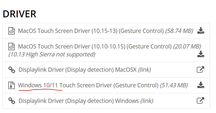

Anyway - the drivers are made (or required) by Reloop (it's always the hardware company that's responsible for creating and maintaining the drivers for a unit), so you should probably talk to them, and ask about general Win11 support
Even though they HAVE put up Win11 as supported for the drivers - at least for the touch screen driver:
(from here: https://www.reloop.com/reloop-touch)

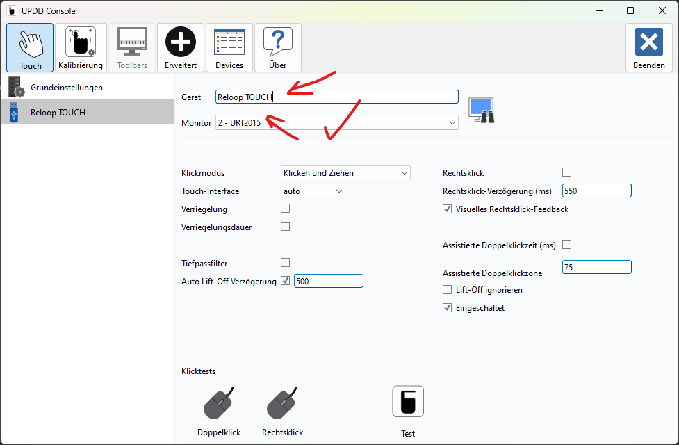

Here i have a Workaround:
My first test was with the Touch connected via USB3-Hub. This has caused some Trouble in history sometimes.
Now i have tested directly connected to the Notebook and - voila! It works. Unfortunately VDJ tries further to download some Driver ... and FAILED... (at every Start)
Anyway: The UPDD Console shows now the Touch Device correct.
And: The assignment between the Reloop Display and Reloop Touch-Hardware can set in the console.
In Win10 i have recently used the Windows tool for calibration touch devices to assign the touch to the correct display. But it seems, that Win11 hasn't this tool anymore. But the UPDD-Console works fine for me.
