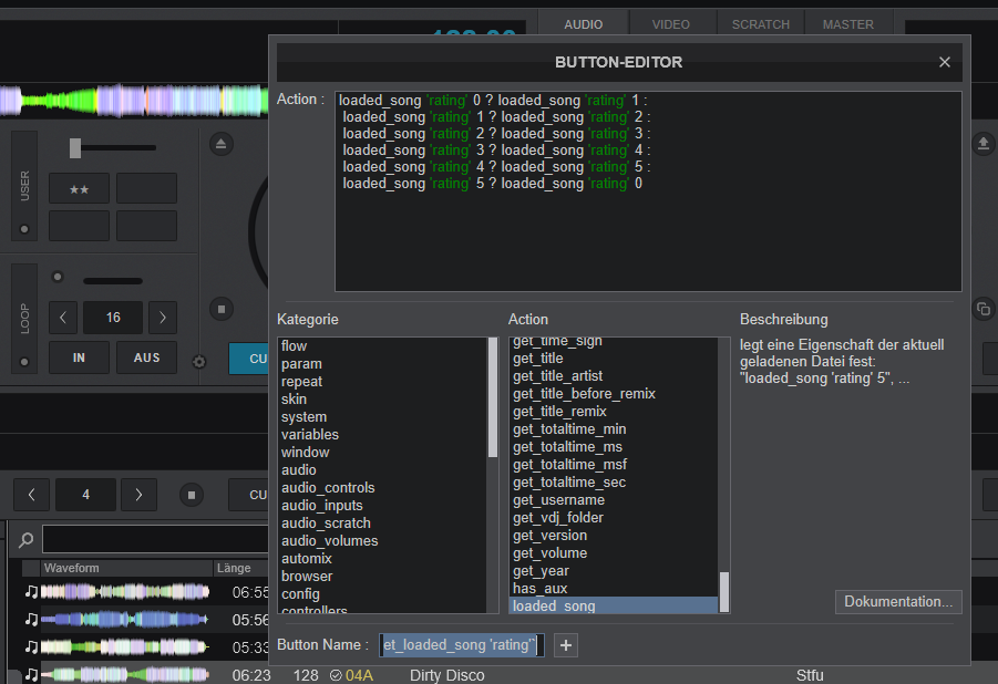

The easyest way is use a custom button :)
ACTION:
Button Name:
ACTION:
loaded_song 'rating' 0 ? loaded_song 'rating' 1 :
loaded_song 'rating' 1 ? loaded_song 'rating' 2 :
loaded_song 'rating' 2 ? loaded_song 'rating' 3 :
loaded_song 'rating' 3 ? loaded_song 'rating' 4 :
loaded_song 'rating' 4 ? loaded_song 'rating' 5 :
loaded_song 'rating' 5 ? loaded_song 'rating' 0
Button Name:
`loaded_song 'rating' 0 ? get_text 'no rating' : get_loaded_song 'rating'`
Posted Sat 07 Jan 23 @ 11:47 am

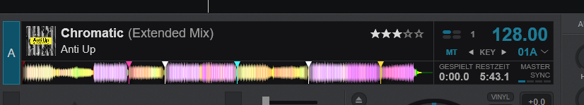

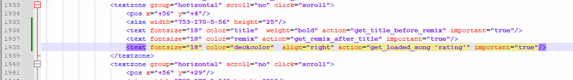

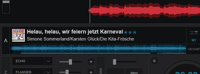

Thank you all. I have some (!!) basic understanding of html. But I am good at copy&paste :-)
I used the default skin (pro) and put that line in (for the left deck):
The result so far:
Does someone know how to align the stars right?
Meiko
The result so far:
Meiko
Posted Sat 07 Jan 23 @ 2:41 pm

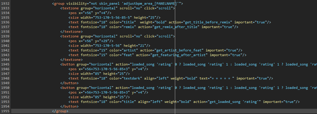

<group visibility="not skin_panel 'adjustbpm_area_[PANELNAME]'">
<textzone group="horizontal" scroll="no" click="scroll">
<pos x="+56" y="+4"/>
<size width="753-170-5-56-85-5" height="25"/>
<text fontsize="18" color="title" weight="bold" action="get_title_before_remix" important="true"/>
<text fontsize="18" color="remix" action="get_remix_after_title" important="true"/>
</textzone>
<pos x="+56" y="+29"/>
<size width="753-170-5-56" height="21"/>
<text fontsize="15" color="artist" action="get_artist_before_feat" important="true"/>
<text fontsize="15" color="feat" action="get_featuring_after_artist" important="true"/>
</textzone>
<button group="horizontal" action="loaded_song 'rating' 0 ? loaded_song 'rating' 1 : loaded_song 'rating' 1 ? loaded_song 'rating' 2 : loaded_song 'rating' 2 ? loaded_song 'rating' 3 : loaded_song 'rating' 3 ? loaded_song 'rating' 4 : loaded_song 'rating' 4 ? loaded_song 'rating' 5 : loaded_song 'rating' 0">
<pos x="+56+753-170-5-56-85+3" y="+4"/>
<size width="85" height="25"/>
<text fontsize="18" color="textdark" align="left" weight="bold" text="☆☆☆☆☆" important="true"/>
</button>
<text fontsize="18" color="title" align="left" weight="bold" action="get_loaded_song 'rating'" important="true"/>
</button>
</group>

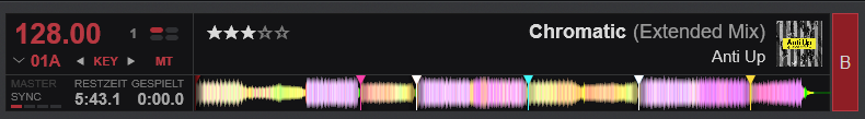

i think this is better :)
by click on the stars you can change the current rating :)
Posted Sat 07 Jan 23 @ 4:03 pm

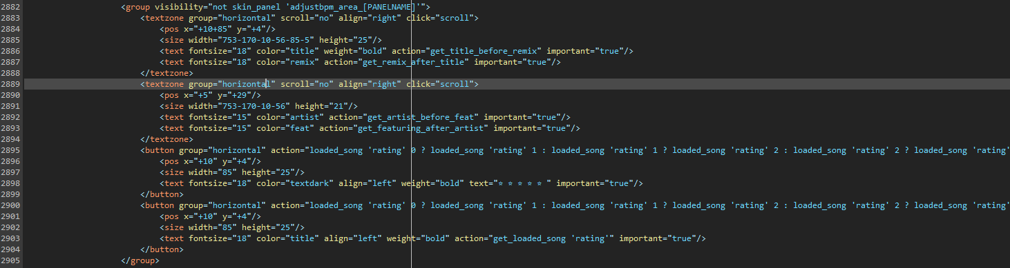

and the right Deck :)
<textzone group="horizontal" scroll="no" align="right" click="scroll">
<pos x="+10+85" y="+4"/>
<size width="753-170-10-56-85-5" height="25"/>
</textzone>
<pos x="+5" y="+29"/>
<size width="753-170-10-56" height="21"/>
</textzone>
<pos x="+10" y="+4"/>
</button>
</button>
</group>
Posted Sat 07 Jan 23 @ 4:08 pm
So, so cool! Thanks a lot!
