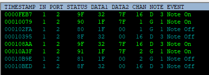

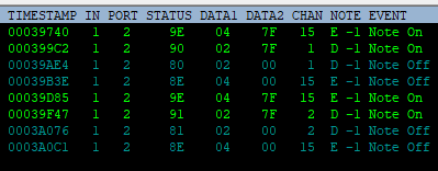

3. here's the screenshots the midi log, first of the sync & second the cue silent.

Can you check (and post the corresponding screenshots) if the buttons send different messages when holding SHIFT and pressing them (for all 3 modes) ?

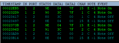

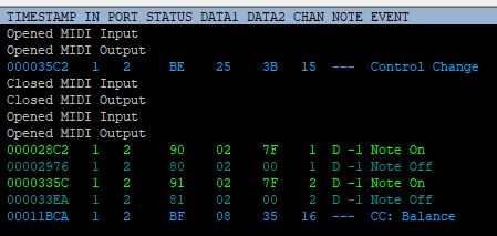

I did "SHIFT + SYNC left" & "SHIFT & SYNC right" on all screenshots.
Screen 1 = SHIFT + SYNC
Screen 2 = SHIFT + SILENT CUE
Screen 3 = SHIFT + INSTANT DOUBLE
Posted Sat 15 Apr 23 @ 7:29 pm
So, basically the "extra" modes (SYNC and SILENT CUE) don't send different MIDI messages when used with SHIFT. Only main mode (INSTANT DOUBLES) does.
