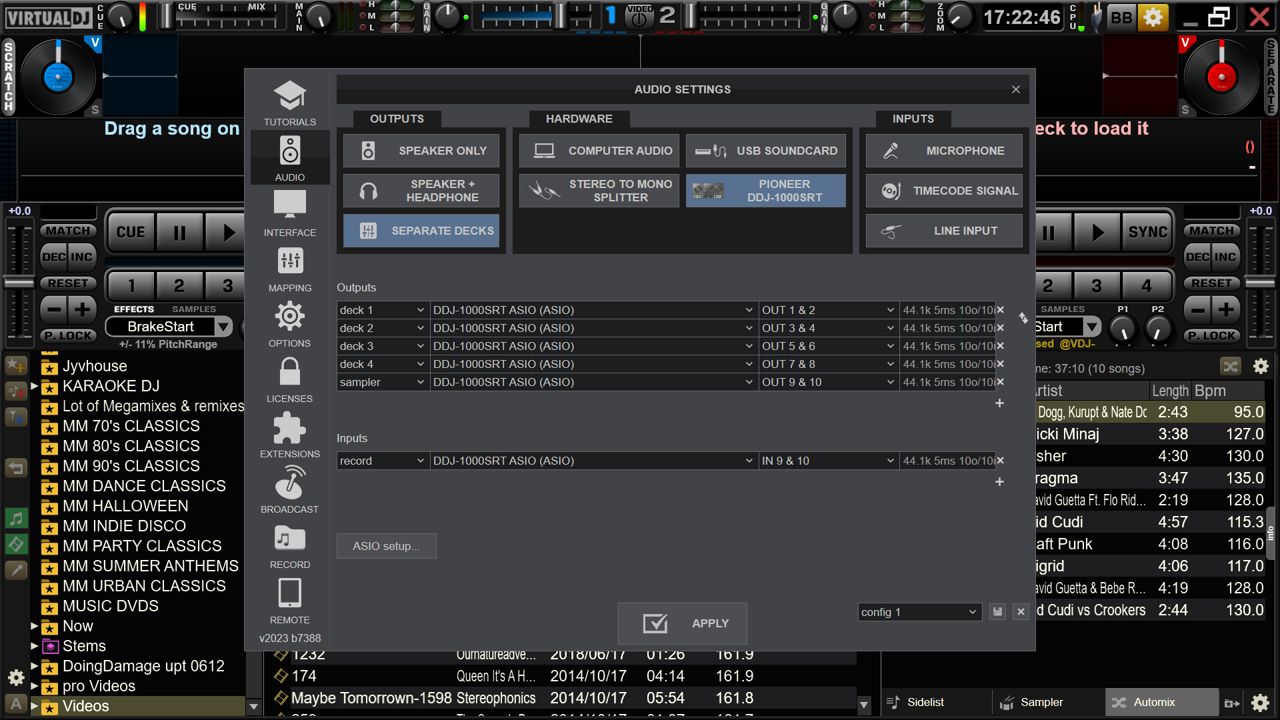

I have a DDJ-1000SRT running the latest version of VDJ, I have noticed that the cue works fine in the headphones but if you move the mix fader over to Master you cant listed the output.
Sound setup wise its set to default as recommended on the Manual (screenshot attached), no matter what setting I try to change I cant get it working fully.
I have tried changing it to Headphone / Mixer but that seems to make it worse, the channels dont work properly.
Any suggestions would be great.

Master CUE Nr.15 is enabled ? https://www.virtualdj.com/manuals/hardware/pioneer/ddj1000srt/layout/mixer.html

Thanks DJDad!
That's exactly what is was, has this controller for a good 18 months, read through lots of forums with no joy & never even noticed that button, easiest fix ever.
