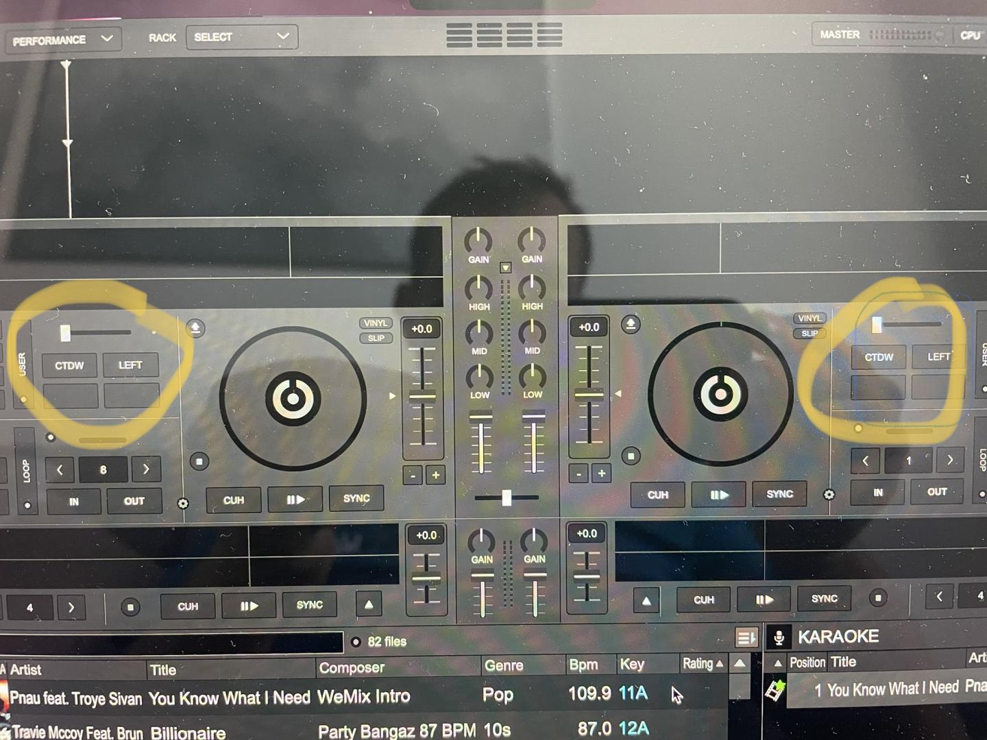

Hi, Is there a way to have different action on Custom buttons on left and right side?

action_deck 1 ? ... : ...

Thanks, tried Deckleft but not worked

But same thing appears on both sides. What I want to do is to have different actions on both sides for custom button 1,2,3,4 using default skin, probably skin limitation

Locodog gave you the answer, did you try that?

Yes but I see same thing on left and right side

Trying to have this on left
action_deck 1 ? clone_deck 3 & deck 1 stem_pad 'acapella' & deck 3 stem_pad 'instrumental'
and this on right side
action_deck 2 ? clone_deck 4 & deck 2 stem_pad 'acapella' & deck 4 stem_pad 'instrumental'

Yes Locodog has posted the solution, unless you wish to mod the XML skin file.

IIDEEJAYII thanks that wil be it

name
`action_deck 1 ? get_text "left" : get_text "right"`
script
action_deck 1 ? clone_deck 3 & deck 1 stem_pad 'acapella' & deck 3 stem_pad 'instrumental' : action_deck 2 ? clone_deck 4 & deck 2 stem_pad 'acapella' & deck 4 stem_pad 'instrumental' :

@LOCODOG
Thank you. Works great. Is there a way to have buttons lit deckcolor.
