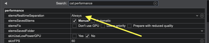

@TheKrazyHouse and @djkarar
I've never had a problem with stems 2.0 on my M1 MBP, so, I checked it after seeing your posts. To my horror mine wouldn't use stems 2.0 as it always has, it was reverting to stems 1.0. I was really surprised. On further investigation checking in the settings and that is where the problem is. It seems an update has changed the setting for stems.
Check your settings and make sure that stemsRealtimeSeparation is set to ALWAYS.
Everythings back to normal after changing the setting to ALWAYS. Phew!

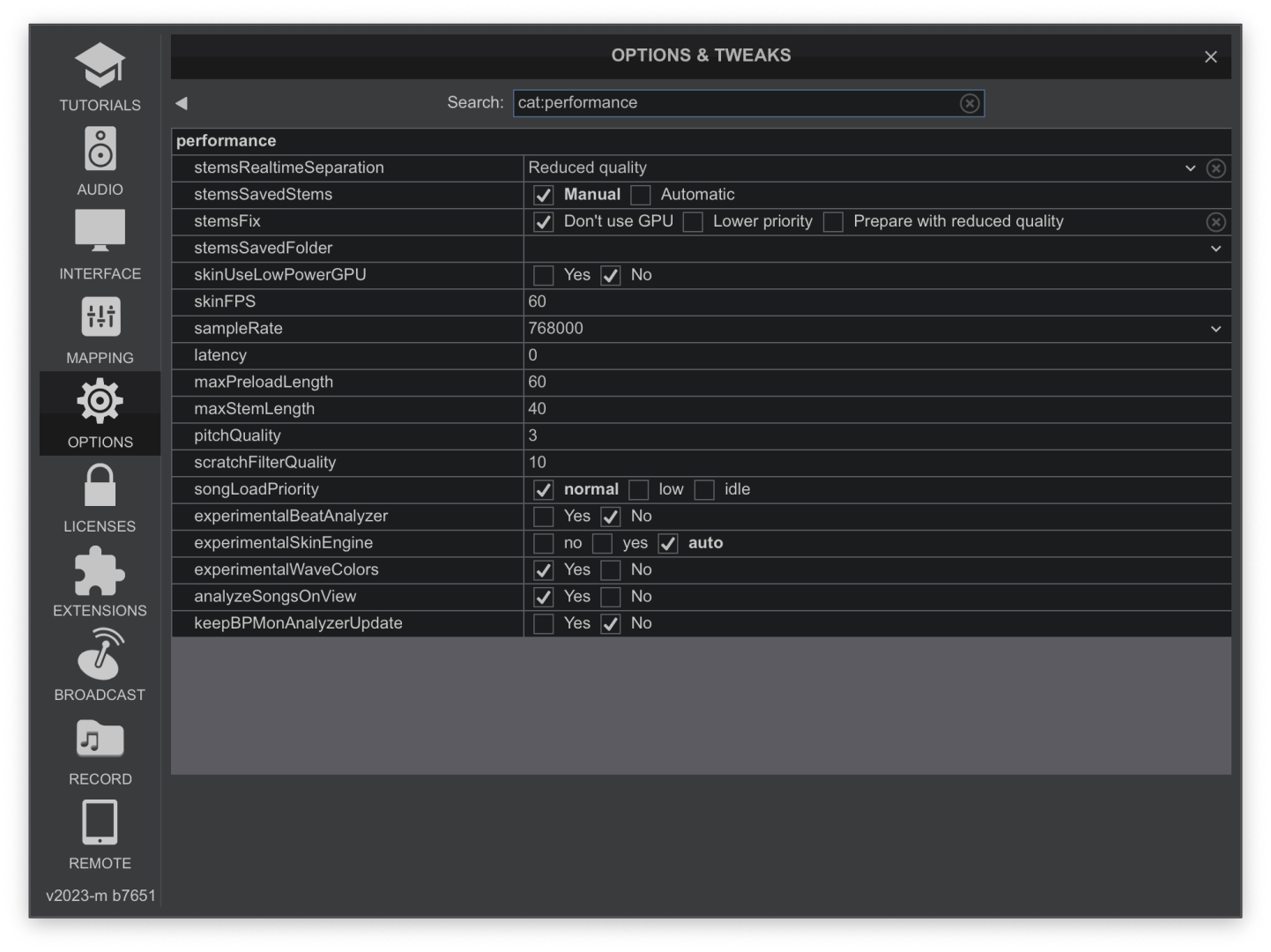

I am having the same issue on my M2 MacStudio - changing the above settings makes no difference. I also tried the below support supplied answer and it didn't work same error - no issues on my M1 Mac or Intel Mac.
Response from support - George: It's possible that SIP (system integrity protection) is disabled on your arm mac which is causing the stems engine error.https://developer.apple.com/documentation/security/disabling_and_enabling_system_integrity_protection

Checked the setting "do not use gpu" to compute stems and now it's going to.
Posted Mon 25 Sep 23 @ 9:13 pm
i choose "Dont Use Gpu" problem solved on mac mini m1 Ventura
Posted Sat 30 Sep 23 @ 3:35 pm
