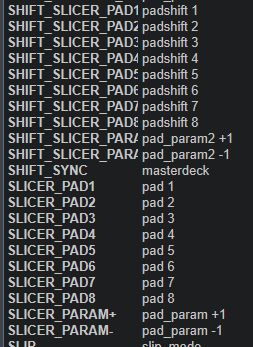

No, that will normally just be mapped to pad 1, pad 2 and so on
Like this mapping on my DDJ-SR
![](/img/384060/15549/Capture.jpg)
And that's then the exact same mapping on the pads in loop and in roll mode, because it will then simply trigger the currently selected pad page
So you can see it as all the pad scripts being elevated a level, so that they don't trigger anything specific anymore. Instead they just tell the pad page to do whenever it's scripted to do for the pad. And then the pad selector buttons simply switch pad pages

Thanks for the info Klaus, i checked and the pads were mapped correctly in VDJ as I expected they would be.
I played about with moving the stem page to a different pad page (from autoloop to slicer) and had the same problem. So I ended finding the issue being the stem.xml for that page. So i deleted the .xml for it from the VDJ folder and recreated it from scratch it now works as expected, so something in the original page was certainly causing the issue.
Just glad i got to the bottom of it as it had been driving me mad for months!
