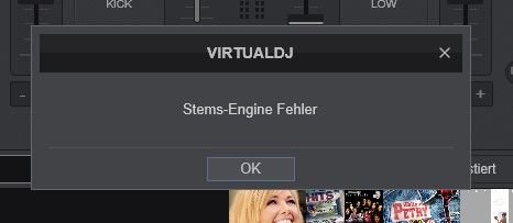

2022/11/22 - 19:24 (7356)
[19:24:28] Stems engine error: 517/6
[19:24:28] Stems engine error: 517/1
[19:24:30] Stems engine error: 517/1
[19:24:31] Stems engine error: 517/1
[19:24:33] Stems engine error: 517/1
[19:24:34] Stems engine error: 517/1
[19:24:36] Stems engine error: 517/1
[19:24:39] Stems engine error: 517/1

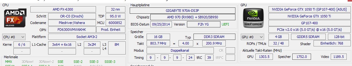

3. the only explanation I see would be that your card ran out of memory during the calculations. Do you have other video-memory-intensive applications running? Otherwise, the next explanation (unfortunately) would be that your card is defective.

I assume that the GTX 1050 Ti is not sufficient for real-time operation. Technologically yes, but not in real time.

The error still occurs!
