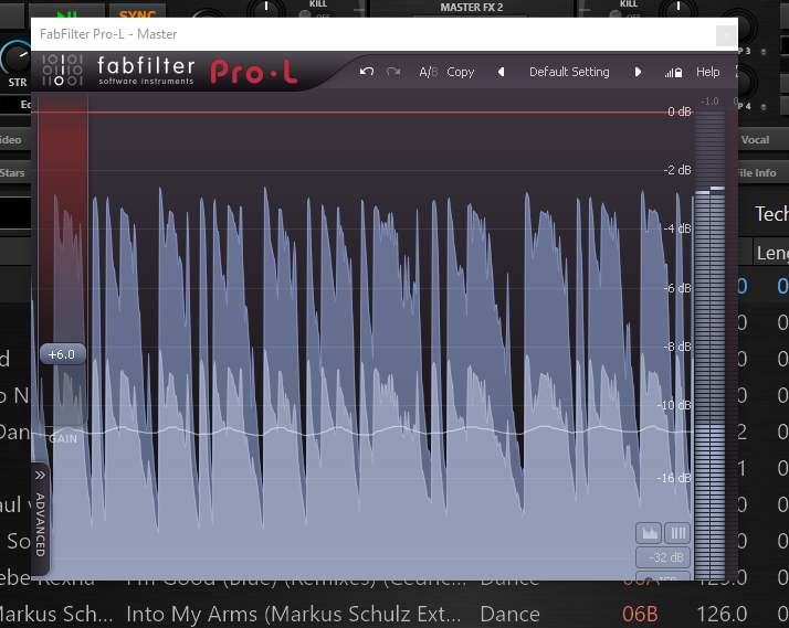

VDJ is also cutting off part of the plugin windows - right side and bottom are cut off

I just downloaded demo of fabfilter Pro L2. Indeed the GUI size at the first load is not right.
But if you click on the maximize button to the right of "help", you can then adjust the size of the window (bottom right)

this is correct thank you but it is also affecting all other plugins i have tried which do not have the ability to be sized, plus the lack of saved settings is a problem.
