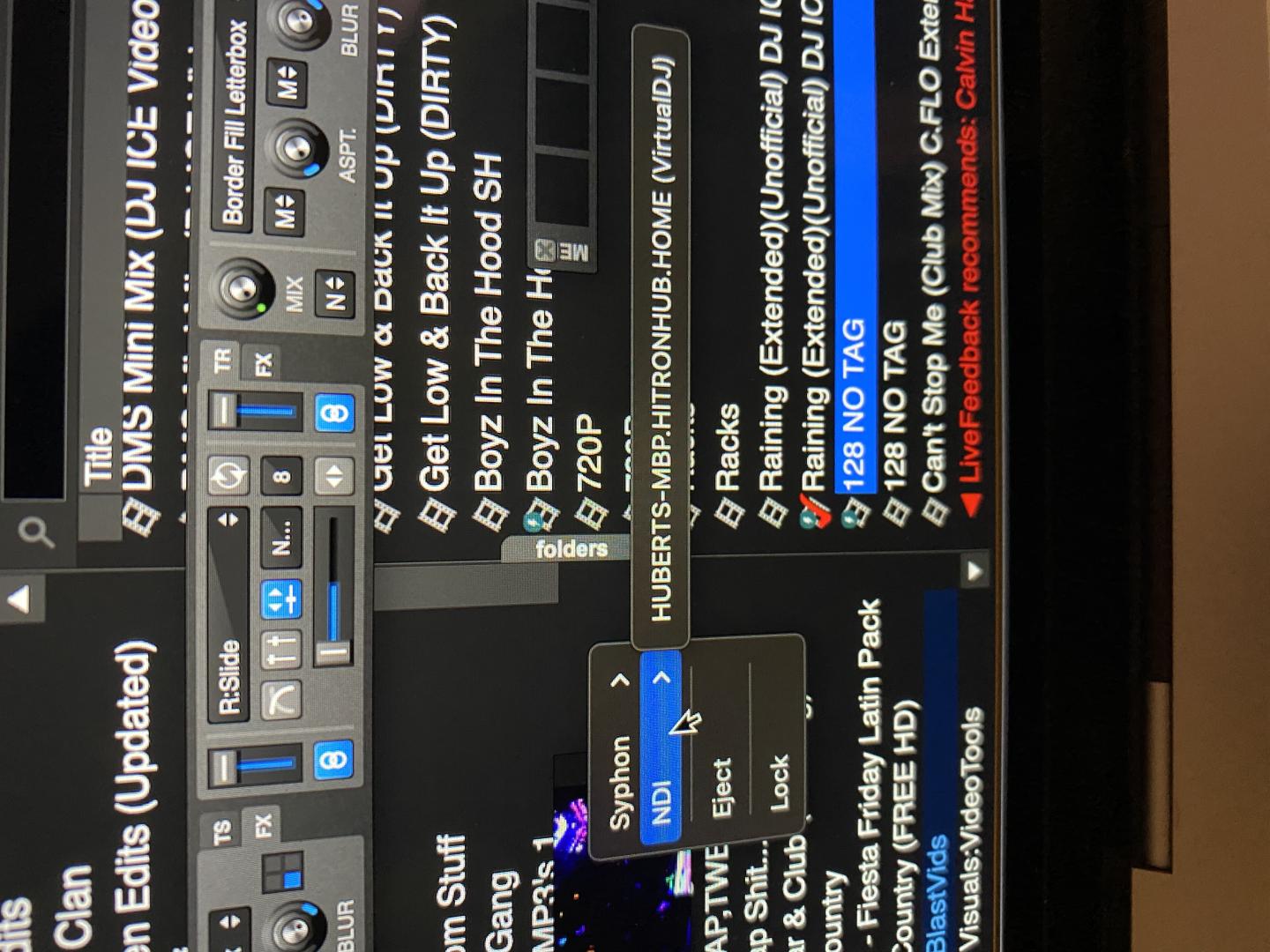

Anyway to separate this so I can use it on each deck??
Posted Tue 15 Nov 22 @ 4:23 pm
Just start the plugin on each deck i think?
Posted Tue 15 Nov 22 @ 4:44 pm
I’ll try it again but I swear it would only pick up 1 or the other (which ever I started first)
Posted Tue 15 Nov 22 @ 5:09 pm
Ah yes, the name of the source is always "VirtualDJ", so probably can't tell them apart.
Posted Tue 15 Nov 22 @ 5:18 pm
Yup that’s what it’s doing.
Anyway to rename the plug-in? Like SENDER2 for example 🤷🏾♂️
Posted Tue 15 Nov 22 @ 5:23 pm
No, it's not based on the plugin name, but I'll update soon so that when used on deck it adds the deck number to the NDI name to make it recognizable.
Posted Tue 15 Nov 22 @ 5:41 pm
Awesome and 🙏🏾
Posted Tue 15 Nov 22 @ 5:45 pm
Update should now be available
Posted Wed 16 Nov 22 @ 1:00 pm

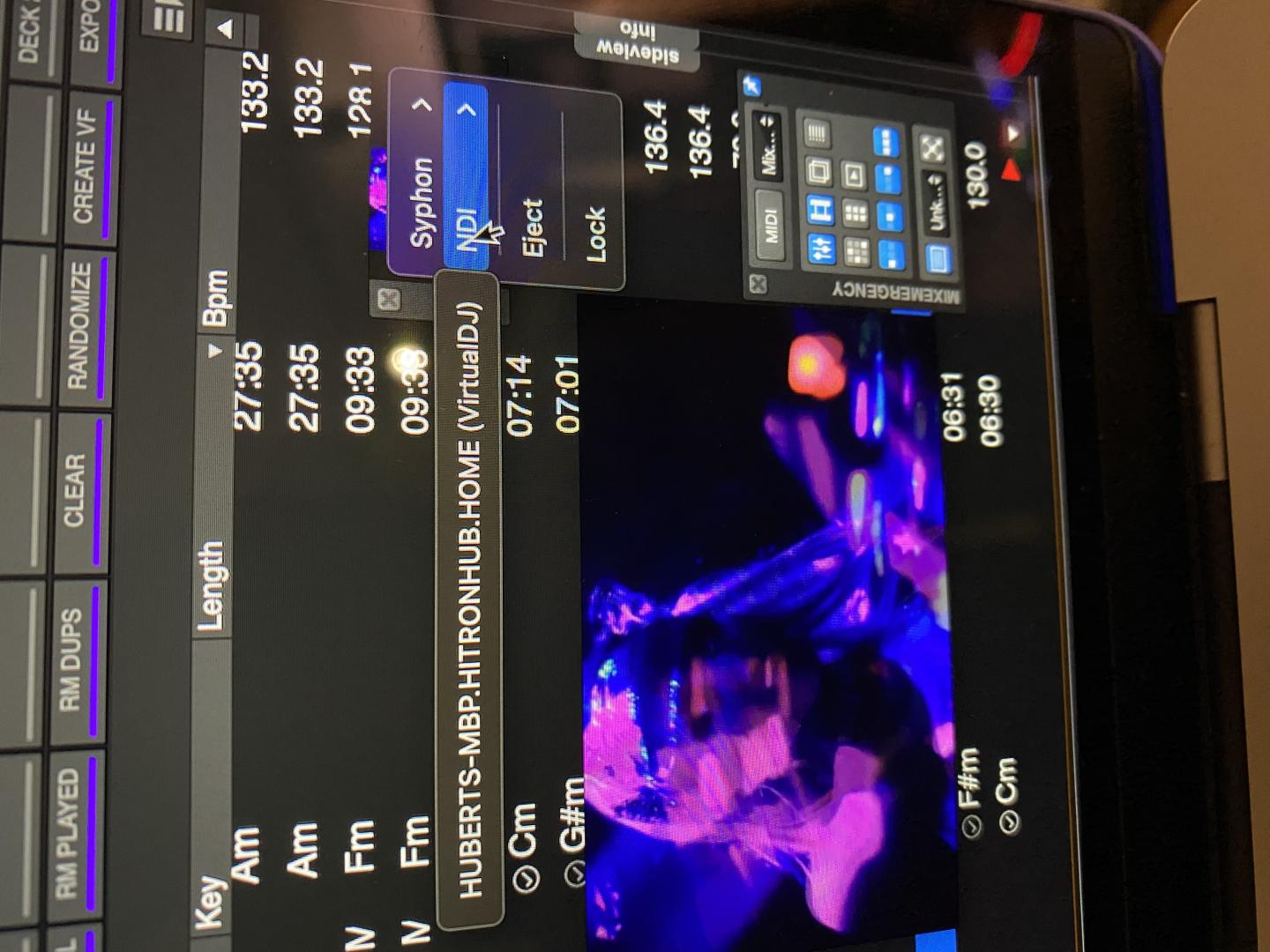

Still doesn’t show up at 2 different Sends.
Only 1 instance of VDJ shows up in Mix Emergency.
The name is the same for both decks
Posted Wed 16 Nov 22 @ 11:14 pm
