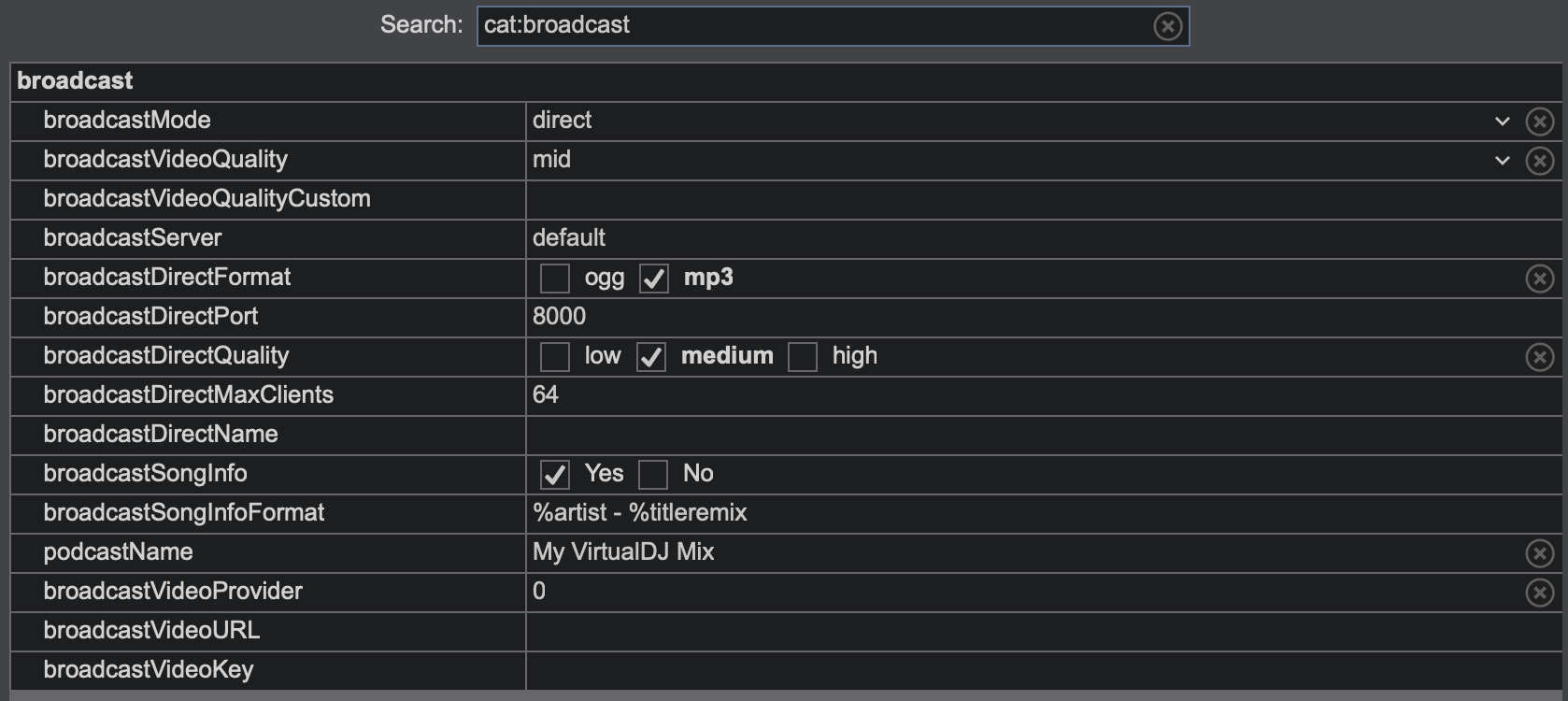

Broadcast settings

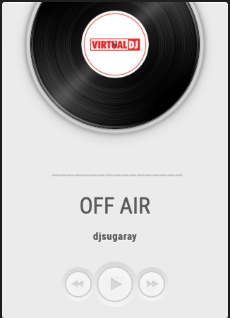

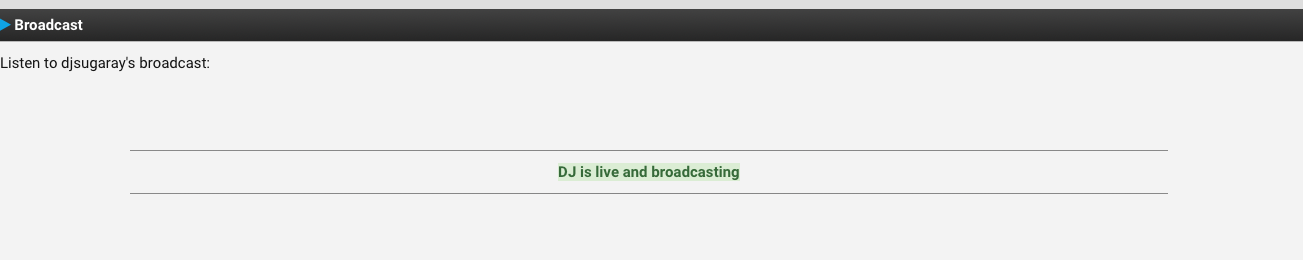

Posted Wed 12 Oct 22 @ 6:24 pm
This is what I get..Thanks

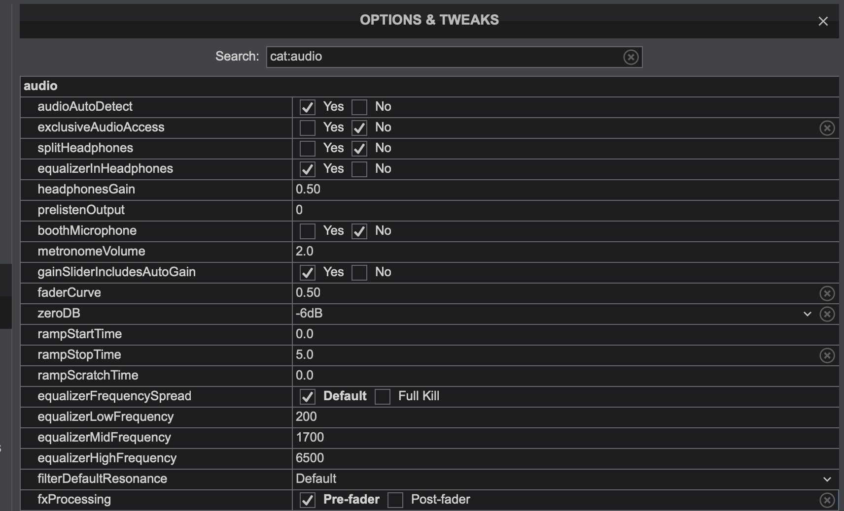

Post a picture of your vdj audio setup
Posted Thu 13 Oct 22 @ 8:56 am
Hi, it’s posted above? Are asking for output setting, channel mapping? Speakers, sound card?
Question do I need to change input to record?
Posted Fri 14 Oct 22 @ 2:13 am
outputs/inputs/hardware a pic of your audio config
Posted Fri 14 Oct 22 @ 2:27 am
here you go.
Posted Fri 14 Oct 22 @ 4:56 am
if you don't have an actual audio feed going back in [which looks to be the case] then delete the input, you're currently using a source that isn't plugged in for broadcast.

Looks like it was a port 8000 issue, when I ran port checker on port 8000 on Tuesday, port checker said it was open, when I check a few minutes ago, port check said it's closed, refusing connection... I set up port forwarding, am now getting audio via VDJ Broadcast link..
