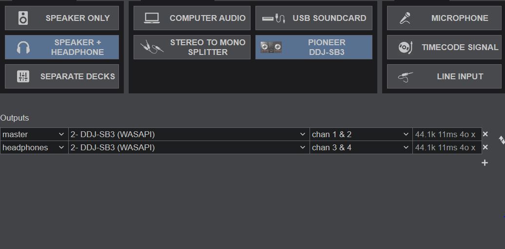

Can you post a screenshot of your Audio setup ?
Posted Fri 23 Sep 22 @ 8:23 pm
here it is
Posted Mon 26 Sep 22 @ 9:27 pm
I am guessing that is correct?

The VDJ Audio setup seems correct.
Known issue : For the DECK buttons to work on the SB3, the Audio Interface of the device needs to be used in the Audio setup, but seems it's not enough.
Please try the following..
- From VDJ Settings->OPTIONS tab, search for exclusiveAudioAccess setting and set to Yes.
- Restart VDJ and see if the DECK buttons work now.
- If still not working, close VDJ, open Sound Settings (Windows) and select your computer's built in sound card as default playback device (and not the SB3 - if selected).
- Open VDJ again and try the DECK buttons.
Posted Thu 29 Sep 22 @ 10:15 am
