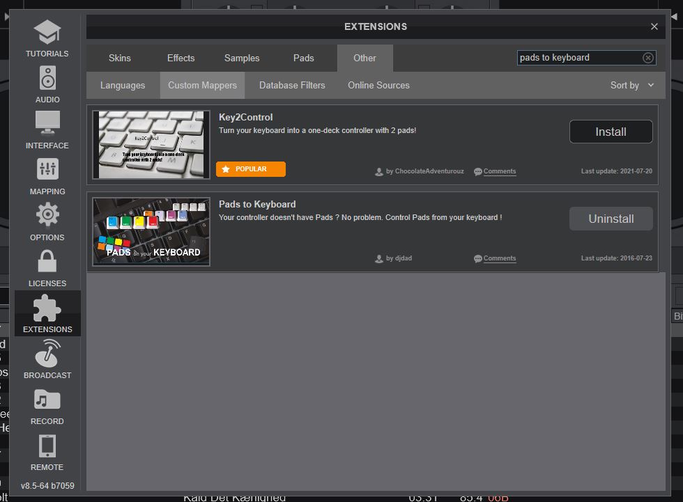

It sounds like you are describing standard loop roll
If so that is already on the pad pages, which is always deck dependent
If you need a pre-mapped way of handling pad pages from your keyboard, you can use the Pads to Keyboard mapping from under extensions
