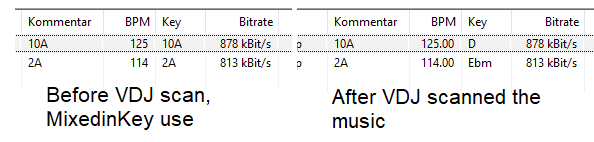

I seem to have this problem, setting Initialkey with MixedinKey. Let VirtualDJ find the folder and it scans the numbers, the setting UseKeyFromTag is "Yes", keyDisplay = "Haronic" but VDJ still changes the InitialKey to the whatever it finds suitable. v2023 b7481
Is there something i´m missing somewhere ?
