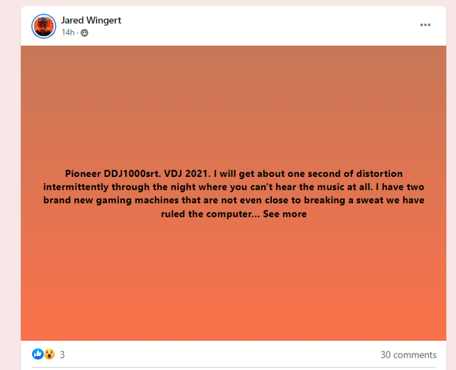

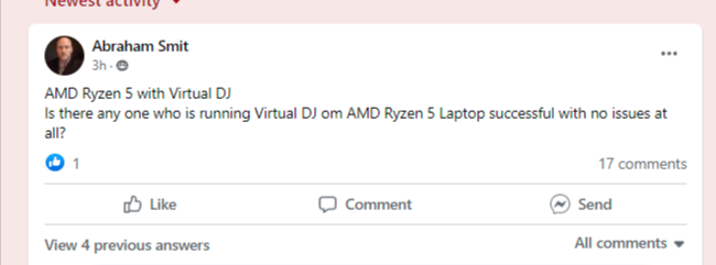

So you have not read comments above? Googled it? https://www.google.com/search?q=vdj+stutter+AMD+Ryzen&oq=vdj+stutter+AMD+Ryzen&aqs=chrome..69i57j69i60l3.7438j0j4&sourceid=chrome&ie=UTF-8 Many are having it, look on Facebook groups too.
Posted Tue 02 Aug 22 @ 8:54 am

another , trust me many are having the issue with VDJ
Posted Tue 02 Aug 22 @ 8:58 am
