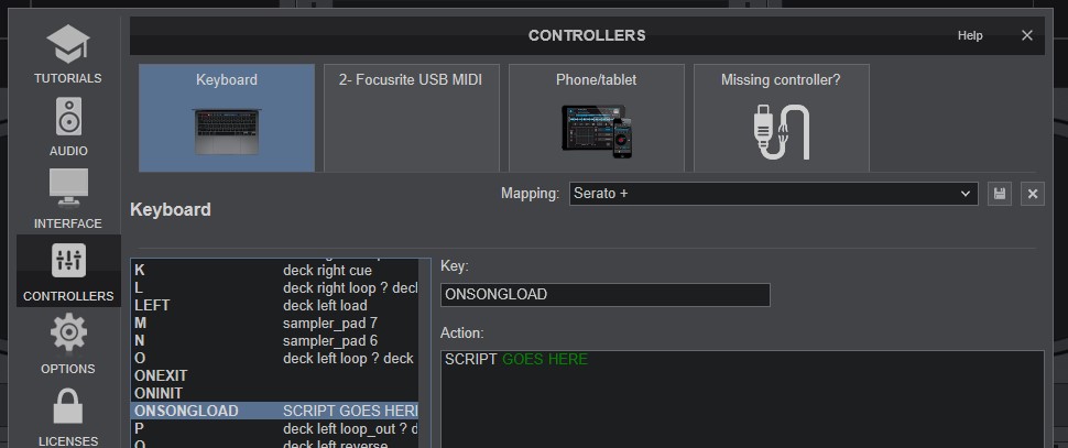

user26542573 wrote :
Where to find ONSONGLOAD?
That will be available on controller mappings
But the trick is then to set it on the controller that is always present - the keyboard :)
So you can find it on the keyboard mapping
It may not be pre-mapped, in which case it will not be in the list of mapped keys, but in the dropdown next to the list
If it IS pre-mapped you can add the new script after a "&" to get both parts executed on song load
Posted Thu 04 Jan 24 @ 9:57 am

Here it is
Posted Thu 04 Jan 24 @ 12:32 pm

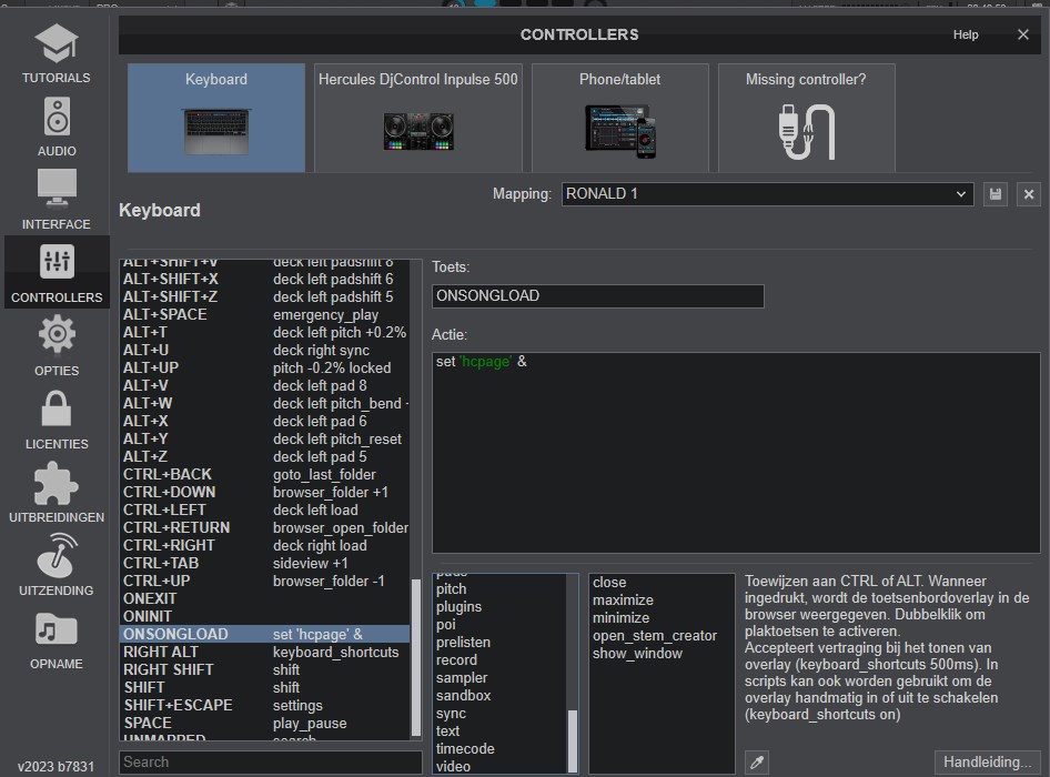

I have done according to your advise and screenshot, thanks for that.
My settings are now as per my screenshot of which I am not sure it is correct.
Can you check that for me?
My goal is that Hotcue XT behaves like the standard Hotcue pads.
Now i notice indeed the = 0.5 sec holding right click for the XT hotcue to be deleted.
Also I noted that the first Hotkey on XT cannot be deleted at all. Only when I delete any Hotkey from the standard pads (first XT hotkey moves to first page) I can delete that one. But then I miss the originally set hot key on the standard page (which is not the idea)
So the question is how to get this done (if possible at all)?
Any suggestions, please?
Kind regards,
Ronald
Kind regards,
Ronald
Posted Thu 04 Jan 24 @ 7:53 pm

I guess that you use VirtualDJ default skin and that you have both "PADS" and "Hotcues" visible at the same time, right ?
Anyway, here are some more details:
1) The pad page should automatically adjust to what cues it shows depending on the sixteenPadsMode setting.
2) Variable 'hcpage' (which is local per deck) takes sequential values from 0 (page 1, hotcues 1-8 or 1-16 on sixteenpadsmode) and up. So, if you want the pads to ALWAYS show the second page, you need to set the value of 'hcpage' to 1 (one)
3) The pad parameter buttons can be used to navigate the pages. If you don't plan to scroll between pages, then there's no need to put something on the "ONSONGLOAD" key. You just need to use the parameter buttons ONCE per deck / per session to scroll to page 2. Then the page will stick there until you shut down VirtualDJ.
The reason I wrote the "ONSONGLOAD" part on the description is for users that scroll through pages often, and therefore wish for the page to automatically return back to 1 (hotcues 1-8) when loading a new song since that's where it's most likely you hold the most important cues.
4) As others said, most likely you have autoSortCues setting enabled. The page itself does not have any special treatment for any hotcue.
PS: More or less the first post on this thread (description of the page) mentions all these allready.
So, if you have not read the first post, please do, as it should clear things up.

Thank you all for responding.
@ IIDEEJAYll:
Concerning my settings, indeed I have autosortcues enabled (= ON and I quite understand how these react as I have it on as from the start)
But what I noticed is when I have the standard HC page 1-8 full and some on the HC XT tab, I can delete all HC on the HC XT tab, except for the last one. Meaning I cannot delete the first HC on that tab.
I need to delete 1 HC on the standard HC tab (not wanted as these are correct) so that the first HC on the HC XT tab moves to the standard HC tab and can then be deleted as usual.
I tried ito delete that one on the Hercules Inpuls 500, but that didn't work as well.
@PHANTOMDEEJAY:
For hardware I use the Hercules Inpulse 500, which works good enough for me as a beginner....
And indeed I have one of the default skins active (Pro or Performance by heart).
I have 4 tabs visible per deck
1 = Hotcues
2 = Hotcue XT
3 = STEMS 2.0
4 = Sampler
as said for preparing my indoor cycling courses over 8 HC are often needed, therefore I installed the HC XT add-on, facing some difficulties which I can imagine are caused by my mis-interpretation of the work-around.
On the Hercules I have 8 pads, so also with VDJ I have 8 pads visible, but then by pushing the second tab I can reach HC 9-16.
what I am looking for is:
the standard HC tab (1) to always show HC 1-8 and the HC XT tab (2) to always show HC 9-16
Preferably HC XT (HC9-16) works the same as the standard HC page which is not quite the same as far as I experience.
with my setting as per above screenshot I experienced that HC XT works correct except for deleting the first HC on that page (wit HC 1-8 occupied).
By removing the 'set 'hcpage'& the HC XT will show HC 1-8 (which are on the standard HC tab already)
The colors on HC XT are always standard white which is fine as I know to find these HC on the second tab ;-).
In case needed I can change colors manually.
Leaving me the question whether I need to adjust my settings or not?
And is the setting for DELETE adjustable faster that 0.5 sec or do I need to live with it (which is acceptable in that case)
Many thanks in advance for your comments and thanks for the help!
Kind regards,
Ronald
